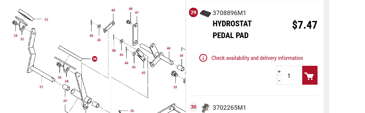

The forward pedal pad on my GC2400 is broken and keeps riding up off the pedal. I haven't been able to find the part number of a replacement, can anyone help?

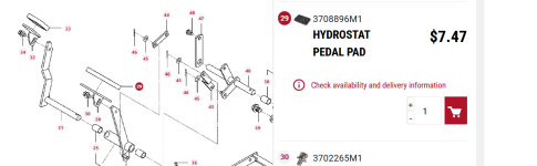

its either 3709558M1 (approx 23$) or 3708896M1 (approx 8$)
suspect its the 8$ one from way parts list shows

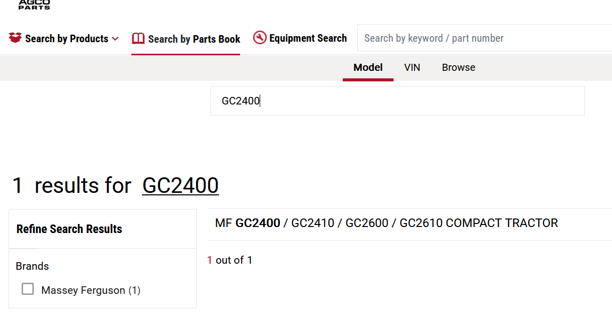

What site is that? I tried looking on the MF site for parts and get nowhere "no GC2400 found" for example. Can you send a link?

go here
choose search by parts book enter GC2400. in order to get prices you will need to create account then choose an online dealer, I'm in maine, closest online dealer was in new york. no matter, if when I call local dealer to order the part I know withing a few $$ what its gonna cost me.

Just a follow up: thanks to the instructions on how to get into the MF GC2400 parts book I was able to determine that the part number I needed was the 3708896M1 Hydrostat Pedal Pad and search for that. The suggested link for the $6.70 pad looked like it might be a 3rd party substitute from China and the shipping cost was excessive, but I found one from Agriteer for about a dollar more and significantly cheaper shipping. It arrived in a couple of days as a genuine Agco part and fits perfectly.
