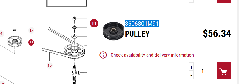

the 2325 and 2326 decks (60 inch) if talking about the idler that is on the spring arm the pulley and bearing are one unit.
part # 3606801M91 and is approx 57$
its the model # of DECK that matters, not model of tractor.

Thanks, you are very correct.
Mine is a 2325 deck
