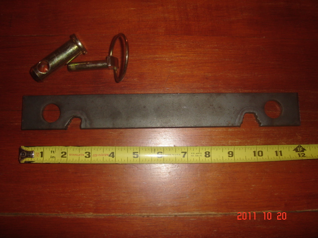

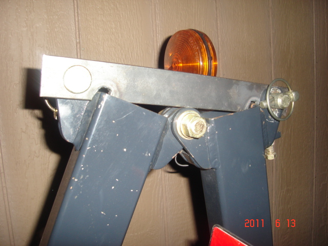

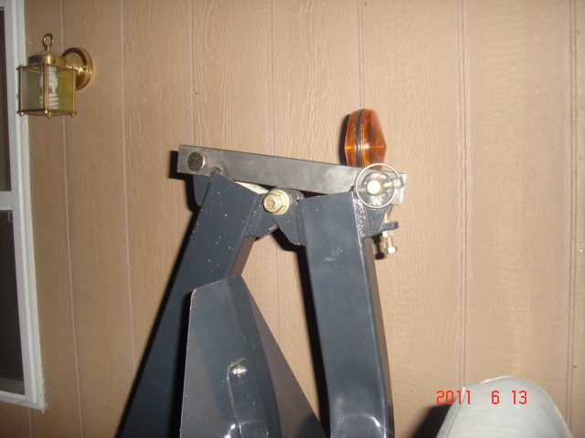

cdaigle-- I made a couple of 3/16" steel straps, for use with pins, to hold the ROPs up just a bit when using the 3PH. WOrks well to keep the 3PH linkage from hitting. Simple, cheap, effective.:D

Thanks IrvingJ, that looks like a solution to me :)

cdaigle- here's a better shot of my "latch." It's long enough to hold the ROPs up/out just enough so the 3PH arms won't hit it. I use the ROPs pins on one end, and purchased another pair for the other end.
I used a cutting torch to notch the bottom edge to accomodate the edges of the ROPs "legs."
