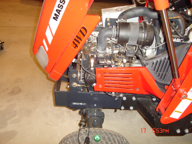

Hey everyone, I hope some of you can help me. I have a GC2410 with 14 hours on it and have had starting problems when the temperature dips below zero.
I use #1 diesel with PS white bottle (2.25oz. to 2.5 gallons).
Tractor is parked in detached, non-insulated garage.
Tractor has magentic oil pan type heater turned on for 3 hours before starting.
I use the owners manual Coldest Weather Starting procedure, ON position for 2 seconds, GLOW position for 15 seconds, then start position.
I crank the engine for 10 seconds, then stop for 10 seconds, then crank the engine for another 10 seconds.
It usually takes about 4 cycle of this cranking and stopping to start the engine.
Outside temperature is -6 degrees F. (at 10:00am yesterday morning)
Garage temperature is +8 degrees F.
Maybe I need to follow the 2 seconds, 15 seconds procedure for each try at starting the engine?
Maybe I need to crank for more than 10 seconds?
Maybe I need to increase the oil pan heater time more than 3 hours?
Maybe I need to get a different type of heater?
F.Y.I. , I ordered this tractor with a freeze type block heater and the MF dealer installed this magnetic type oil pan heater. I questioned him about why I didn't receive the type of heater that I ordered and he told me that "the freeze plug type heater would not fit".
This statement is different then whats on the MF owners manual, page 35:
"Installation of accessory engine block heater is recommended in cold weather conditions. Contact your dealer."
Maybe someone can tell me if a block type heater is available and fits this tractor?
Thanks, KC
   / GC2410 Coldest Weather Starting problem #2

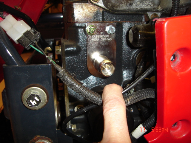

MF Red-- if your engine looks like the pic below, the freeze plug heater should work. (Right above the oil filter.) Mine was expensive at $140 or so, but it fit like a glove. It came with only one bolt, however, so I had to get a second, and I think it was metric- dealer had one. (Apparently there used to be one already in one of the holes, but had been eliminated in later 2310s.) Putting that heater on larger tractors can be a real pain, because there's other stuff in the way that needs to be removed first, but the 2310 wasn't bad at all.
There's a thread on that-- do a search.
When I start mine in cold weather, I hold the glow plugs on (key to left) for half a minute or more... and may still repeat. I hadn't heard about the "15 second" deal. Maybe yours is different? You might want to try just holding "glow" for a longer period of time.

Thanks irving, did your block heater just fit into the freeze plug hole, or did you have to remove the plug? I see the 2 threaded holes above mine where it goes. I forgot to mention that I set the throttle lever half way. I will call a different MF dealer tomorrow to order the part as I am fed up with the dealer I purchased it from (many other little troubles from that dealer). I am not a hard person to please and I have reached my limit with this dealer.

Yes, you have to drain the coolant and then punch a hole in the freeze plug & remove it. Don't drill it, as this may leave metal shavings in the cooling jacket. Also, be careful not to ding up the edges of the hole in the block. The heater has an O-ring seal that, in my case, fit perfectly. Not a bad idea to put a bit of vaseline or silicone grease --or similar-- around the O-ring when you install it. Mine never leaked a bit. There are more deatils in the thread from last year on this.
Also, if you have a hose-thread cap (or even a Coke bottle cap I think might work), you can thread it onto the end of the heater during summer to keep goop out of the electrical connection, and store the electrical cord inside in a safe place.
Oh, yeah, I forgot-- it's a LOT easier if you remove the grille & a bit of the side panel! (Just a few #3 Phillips screws, maybe a couple small bolts.)
