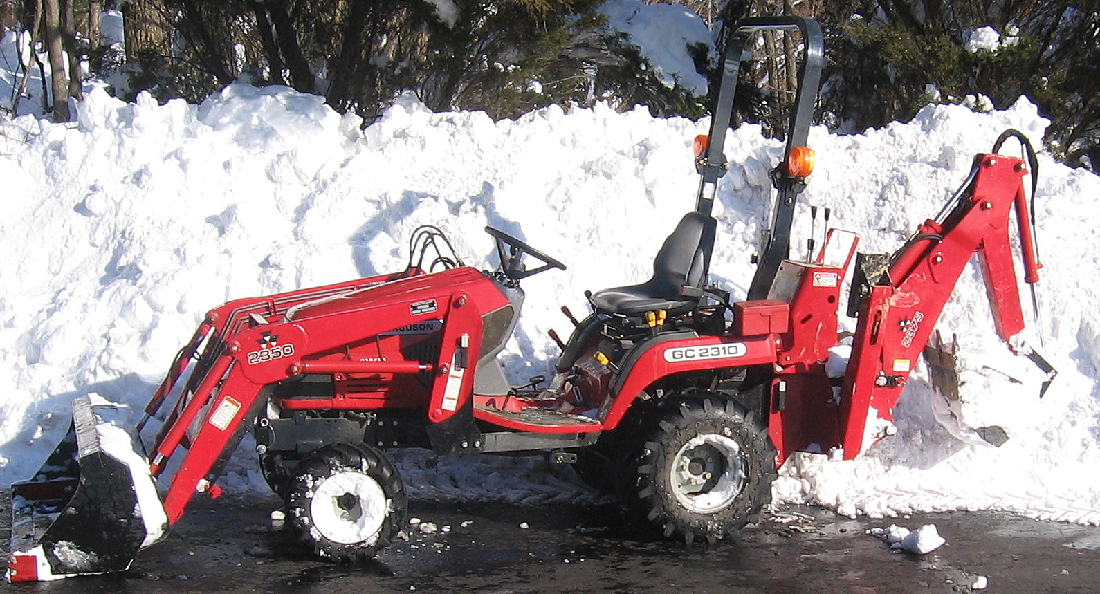

I've using my FEL to move snow for 5 years now. On the 2310 the hoe does stick out a bit and have backed in to a couple of things. Thought about getting a rear mount blower - have to wait till next winter.
