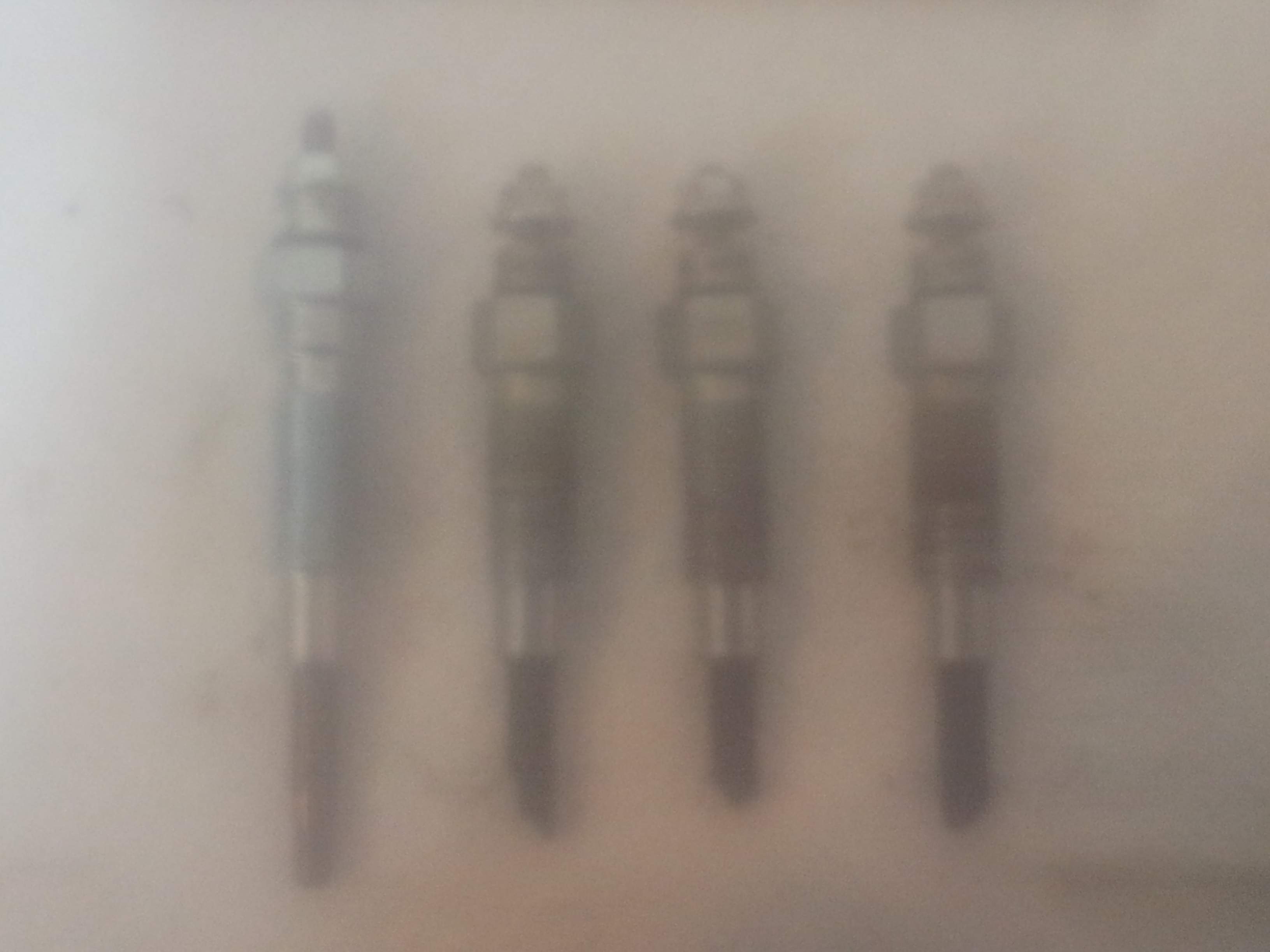

lol! I pulled the plugs, but the testing part was not necessary.
I know the picture is crappy, but my phone lens is hooped. as you can see, the new ones are overall longer than the originals, the ends are all missing from the originals but they still seem to be full width down past where the replacements begin to taper so I'm hoping the new ones wont be too long
I'm just taking a break for breakfast then will install the new block heater and park it outside for a while. It's right in the neighbourhood of freezing today so it shouldn't take too long to find out if these plugs work any better than the originals did when they were new.
btw, did the swap with the fuel lines and injectors in place, next time the plumbing will come off first. kind of frustrating job with the front end loader on and in a tight shop
I did get ngk numbers from the originals and will post all that stuff when the job is done.

Looks like maybe you found the problem!
BTW, I got confuzzled… my car's an '05, but the tractor is an '07. Still, that battery is holding up well -- not bad for 7 years. (Got a piece of wood handy??)
I'll check my glow plugs soon; I remember seeing the same thing on a Peugeot 504D I had for a few years; the ends of the plugs on a couple of them were also burned off, just like in your pic. Had forgotten about that "normal" wear & tear. ijk

well, it starts with one 13 second application of the glow plugs at 37*F, so I think its safe to say things are looking up.
btw, I did check the ground cable, it looks like the day it was new. :thumbsup:
the OEM plugs are NGK Y510R 0923 there is slight chance that number is y51Dr but I dont think so, just in case.
the aftermarket plugs are to fit the E3112 engine from the '90's the number on them is JAS31M1 12V E22 dont know the brand unless JAS is a brand.
while I'm at it, Injector # is 6242143M91 AGCO Block heater number I will edit in after another trip to the shop.:laughing:
