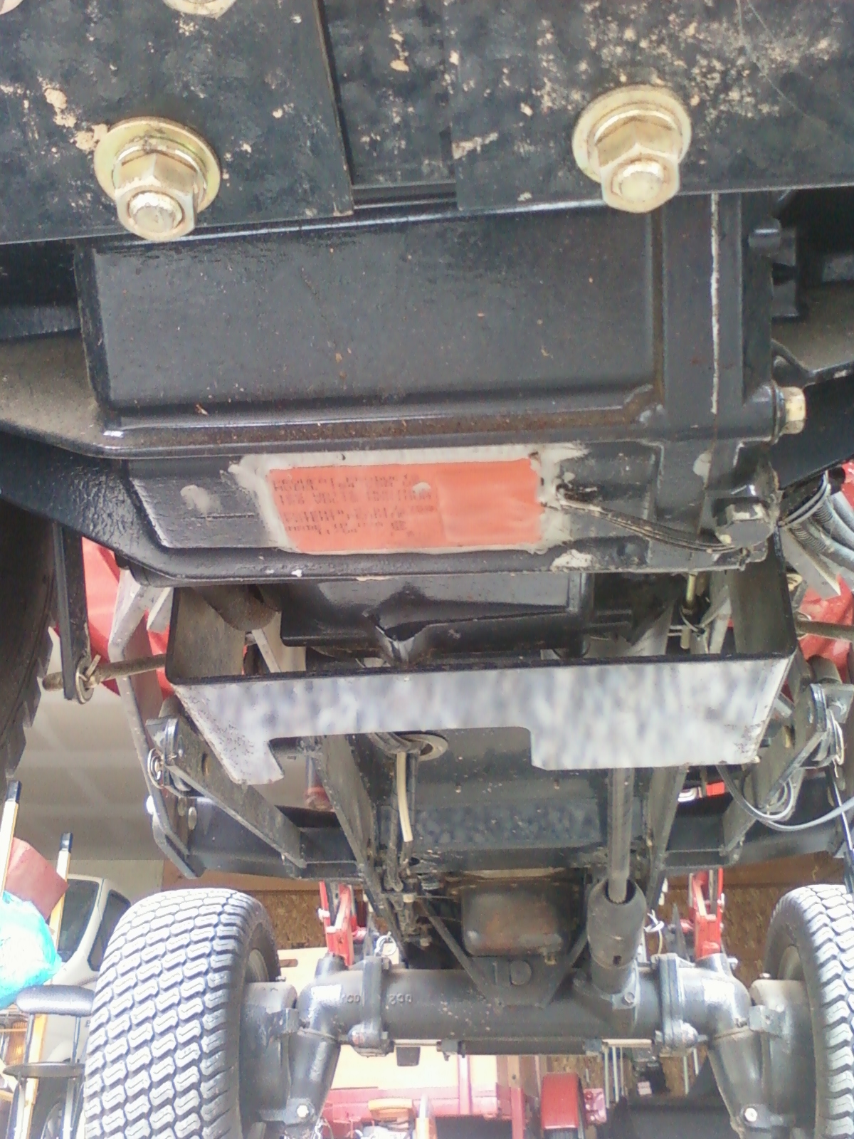

Another way to protect your hydraulic pump from cold weather: This silicone pad heater, (orange colored device below), is glued to the bottom of the rear axle housing. It uses 140 watts of 110 volt ac power. I plug it in when the forecast is for impending snow.
In 24 hours, it warms the oil considerably. In 48 hours, the entire housing is no longer cold anywhere. I have left it plugged in for as long as a week at a time, when we have had periods of continuous snow.
With this you really can shorten you warm up times, because your oil is not cold to begin with.
E-bay seems to have the best selection of these.
As an experiment, I am also running a 25 watt pad heater on the engine oil pan this year.
It rarely gets much below 32F in my shop, which is certainly helpful too.
