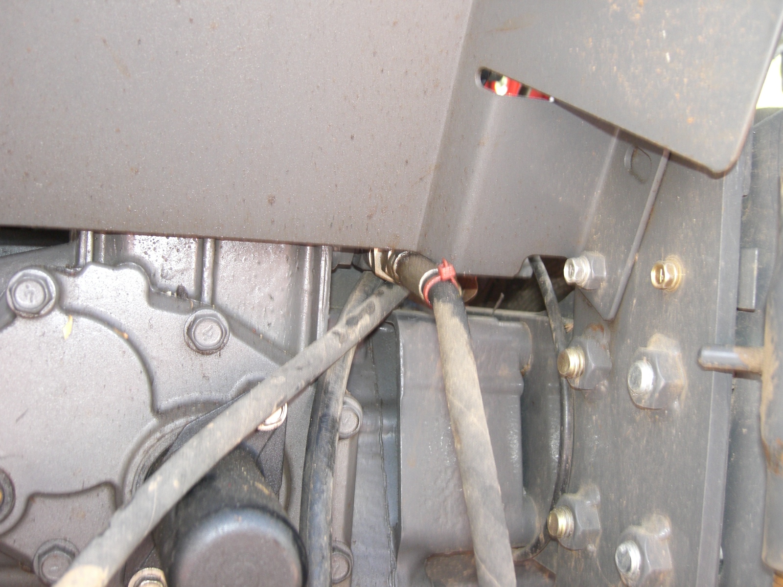

I think I need to know on those tractor that have 3 hoses where the hose that isn't connected to goes on the tractor, so that would be red on your tractor. I can't see on Irving's photo what the color of the hose is that connects to the tractor just below the 3pt pivot shaft.
I have attached a photo which shows where my red hose (female coupling) connects to the tractor just below the 3pt pivot shaft.
Hope this makes sense
Thanks
I just re-looked at Irving's photo it looks like his red hose is the same as mine and connects just below the 3pt pivot shaft. So my problem is two males !!

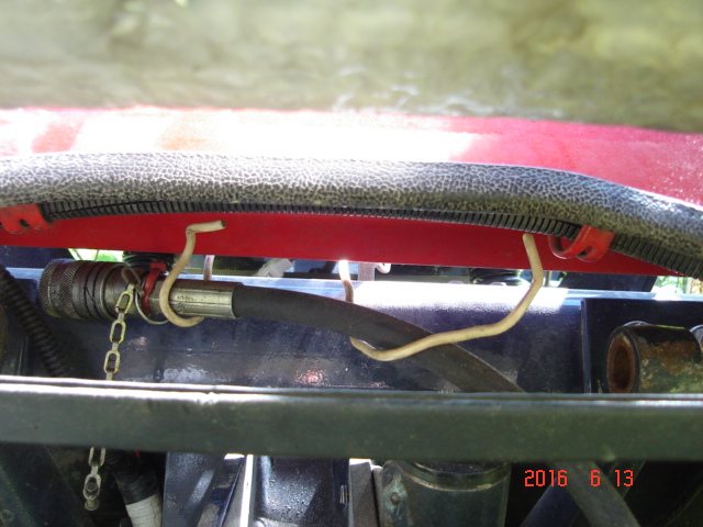

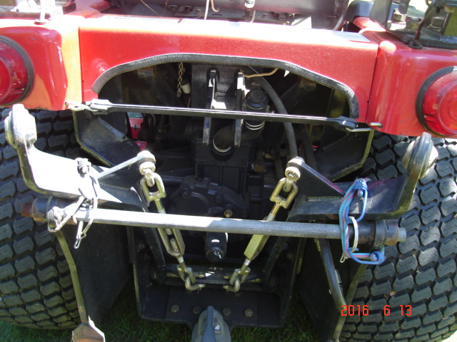

Just saw this-- glad you got it figured out! On mine, that hose with the 90 degree end on it just below the 3PH arm is a female end, marked red, and just lays there when the BH is off. When BH is off, I have a piece of #10AWG wire that I have hooked to the seat frame at the back and use that hold the "red" hose suspended and up & out of the way.
I also have a piece of EMT to hold the 3PH arms out of the way when mowing, as those 3PH arms still need to move up & down when raising & lowering MMM. (Hopefully without cutting any hoses!:eek:)
Here's a couple pics of my set-up:
