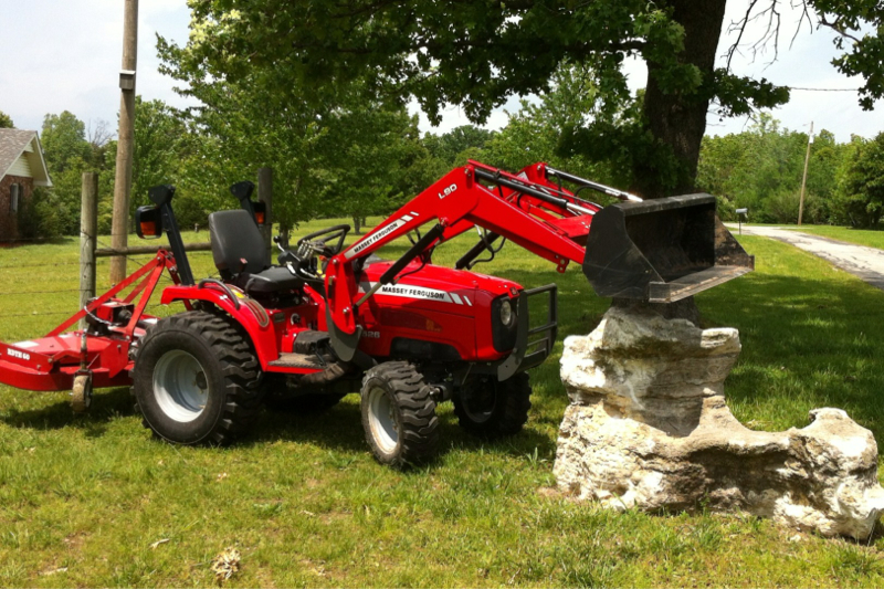

I have a 1526. No it didn't move this rock haha. I seriously looked hard at both the 1526, GC 2610 and 2410. I don't think I really needed a backhoe. I couldn't see getting a 2600 when for 1500 more I could have a considerably bigger tractor. I really like the 1526. It is fun to operate. I have the hydro which I would not have any thing other than a hydro. One thing to consider is that the 1529 is only about $700 more and you have quite a bit more loader. I just didn't need that much more loader.
