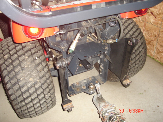

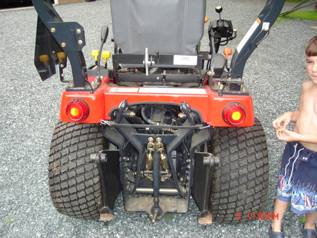

I'm having trouble finding a good way to keep my hoses stowed away while the BH is not attached.
How do you route them so they're secure and out of the way of the 3pnt and rear PTO operations?
   / GCxxxxTLB Owners. How do you stow your Hydraulic Hoses #2
Since I don't --as yet-- have any 3PH attachments, I've removed the 3PH altogether (a la Kubota, I guess!:eek:); however, I've experimented with hose-routing options....
At first I tried just looping the return line over the fill cap neck; later I just went around the bungee and then connected, so it would stay up. The "free" line I tucked up onto the top of the HST. So far, so good, but I had considered installing some clips if, I were going to use the 3PH.
