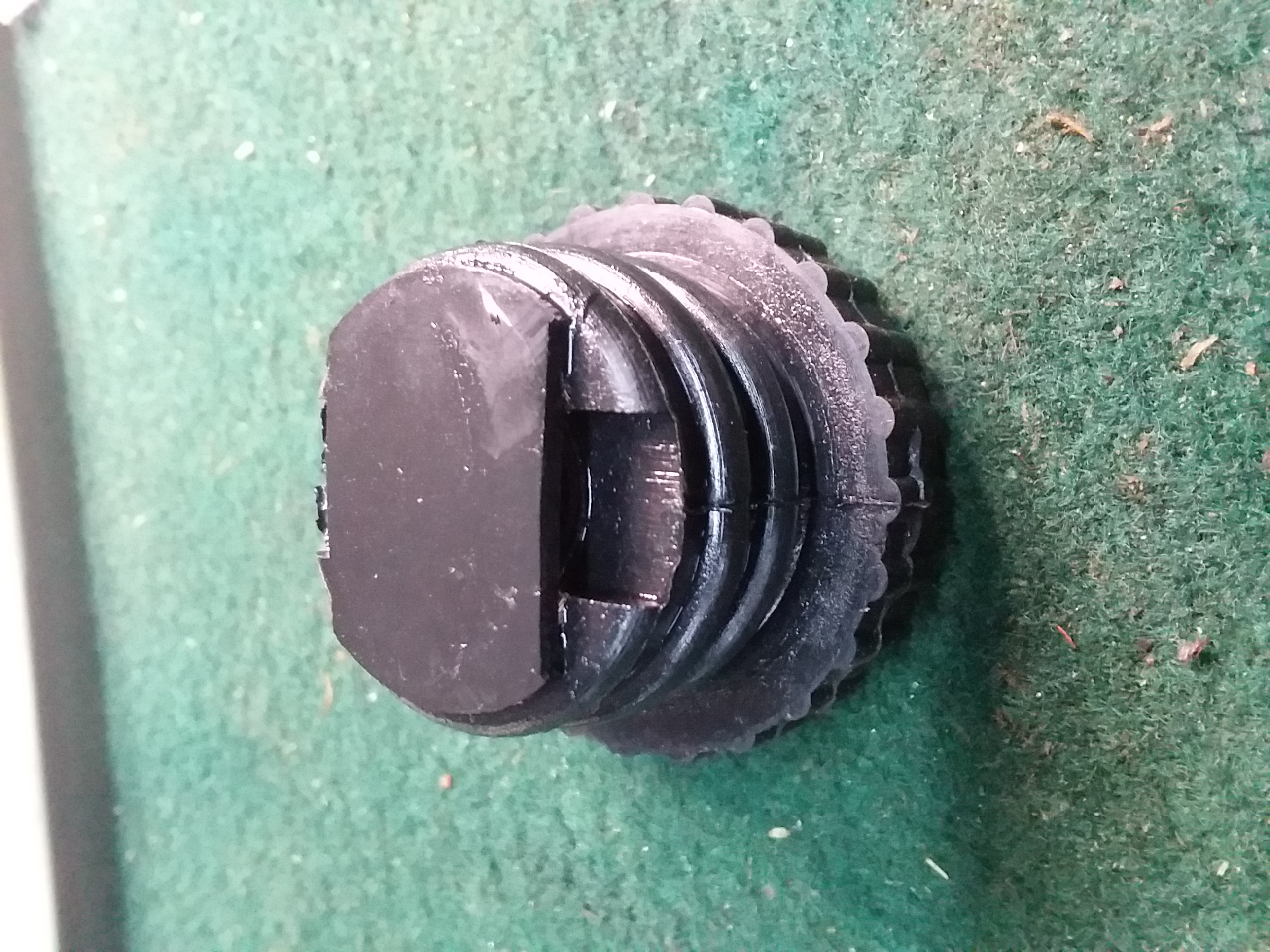

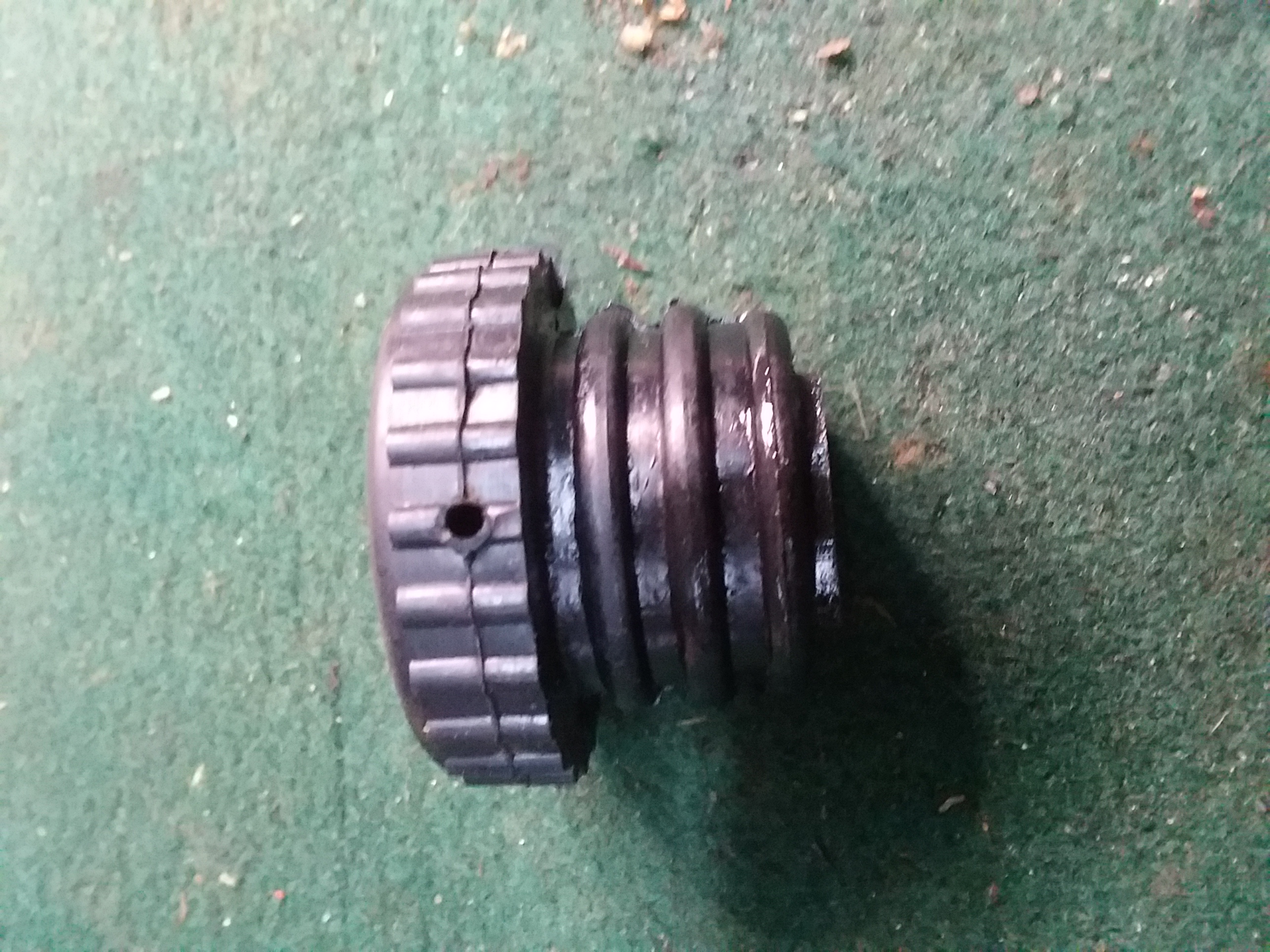

I Just purchased a new 2018 GC1720. So far the tractor has performed flawlessly. I have about 10 hrs on the tach and decided I should look the tractor over for any issues. When I removed the fill cap for the transmission I was surprised to hear a good bit of pressure escape from the filler neck. The tractor had been sitting for a couple days, fluid was cold. The fluid level was just below the sight glass and there was no signs of leaks anywhere. I spoke to the dealer and asked if that was to be expected. I got somewhat of a non-answer but left the conversation with the impression that it was not normal. I looked all over the transmission for a vent but could not find one. The cap itself appeared to possibly be a vent. There is an observable hole in the plug with what appears to be a rubber baffle over it (See Pictures). There is a very small hole in the rim of the cap. I could not blow/suck air through the hole. Searched the internet and could not find any information on the vent design for the gear case. Closest I found to a vent issue was a gentleman who had his sight glass blow out.
I eventually gave up searching for info and took a 1/16 inch drill bit and carefully pushed the blunt end into the rim hole. I could feel it bottom out. Pushed slightly harder and felt the drill bit push through some thin 20190417_210649.jpg20190417_210709.jpg rubber. Now air passes through the cap and I no longer get pressure build up in the gear case.
Questions:
1) Did I have a bad cap or did I break a feature of the cap I shouldn't have?
2) Is there not any other vents on the Gear case? I would think that the change in gear oil volume as the hydraulics are actuated would necessitate more than a 1/16 inch breather hole.

Mine is so loose air can get by it anyway. the sight glass should show between half and 3/4 with the loader down.
   / Gear Case Vents on MF GC1720? #3
They don't really fit that snug, if enough pressure built up that cap would get ejected and then you would know it was too much pressure. It certainly isn't going to hurt the machine if you cleared/opened the passage.

I appreciate the feedback. More of just a curiosity now...Next time I am at the dealer I am going to pull a cap and see if that small hole is really intended to be a vent.
