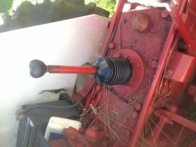

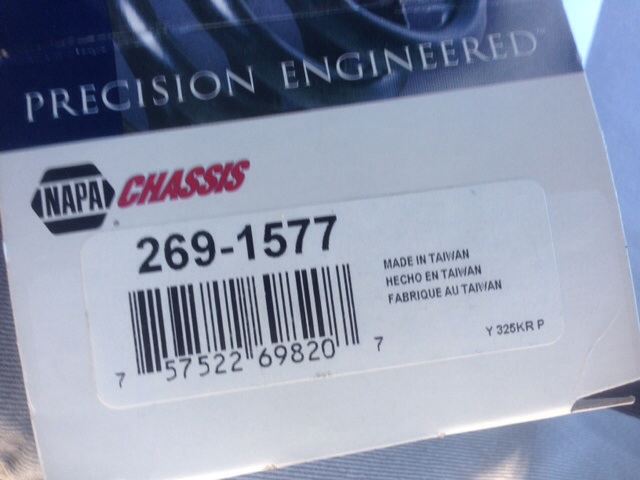

I know this is an old thread - the email address above doesn't work. I looked around and was able to find that Napa part number 269-1577 (power steering / cv boot) is a great fit to replace a Satoh shifter boot. It took some elbow grease and a little prying for the bottom seal, but once on its a very durable water tight seal. Below are an image of the end of the box from napa for reference and a picture of how it looks on my Satoh S650-G. These forums are the absolute best source for information on satoh tractors, Satoh owners, please use and post to them!

That looks pretty good. Nice job.
View attachment 393475View attachment 393476
I know this thread is pretty old by now, question for you though? Does the 4 bolts around the bottom of the shifter come off and the bottom of this NAPPA boot slide in there? Or does it just slide overtop of that plate? It kinda looks like a zip tie around the bottom of your boot but I can’t quite tell.
Thanks in advance
