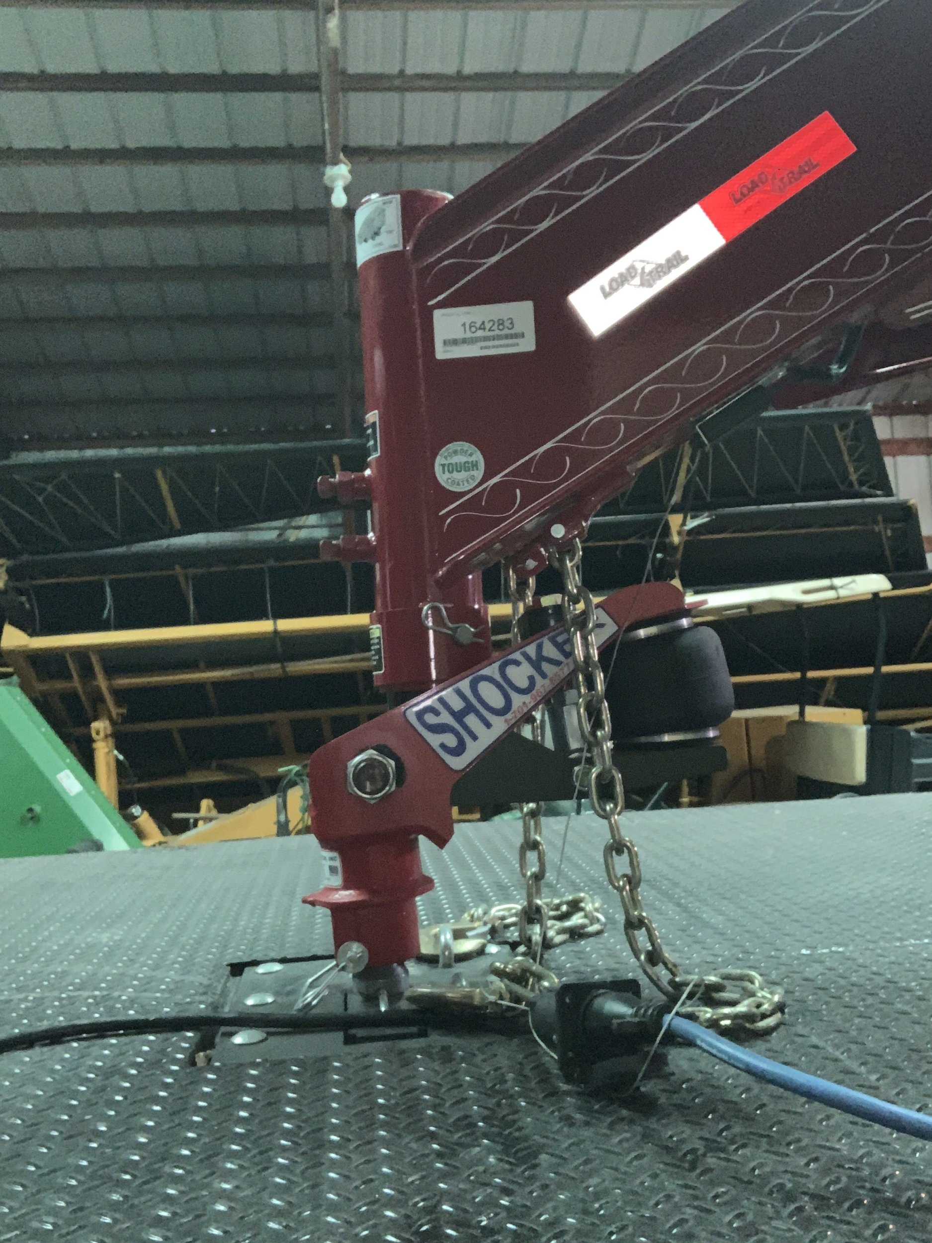

I’ve got the 30k rated Shocker on my 25k tandem dual GN , smooths the pull out a lot. I run about 30-35psi in the air chamber when pulling heavy , works great. I’m not familiar with the gen y

I have a shocker hitch on my 32' gooseneck. Admittedly, I've never pulled the trailer without it, but everyone who rides in my truck remarks at how incredibly smooth it is loaded or empty. I run about 40-45psi in the bag.
