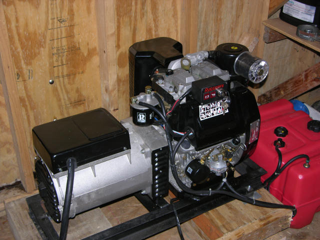

I have at my house a 10KW diesel genset. Works very well and keeping the house up only burns about 1/2 gal/hr.
paul
What brand?
Bob

Doc_Bob said:
What brand?
Bob
To be honest, I do not know the brand. It is a Deutz 2 cyl diesel woth a Mecc Alte alternator. It was sold as part of the Y2K frenzy, and later they (yea there were quite a few of them) were sold as surplus. New and only run for factory test. I got it for $ 1900.
paul
