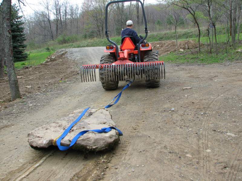

Here is one way to move rocks (although I think it might be less desctuctive to the driveway with the car hood /forums/images/graemlins/grin.gif).
I move rocks all the time so let me know what size you are talking about.
If you really mean "how do I harvest rocks" there are a few rock buckets you can buy that will skim the ground and collect the rocks for you. I've never worked one but if you search TBN you should find some pictures.
