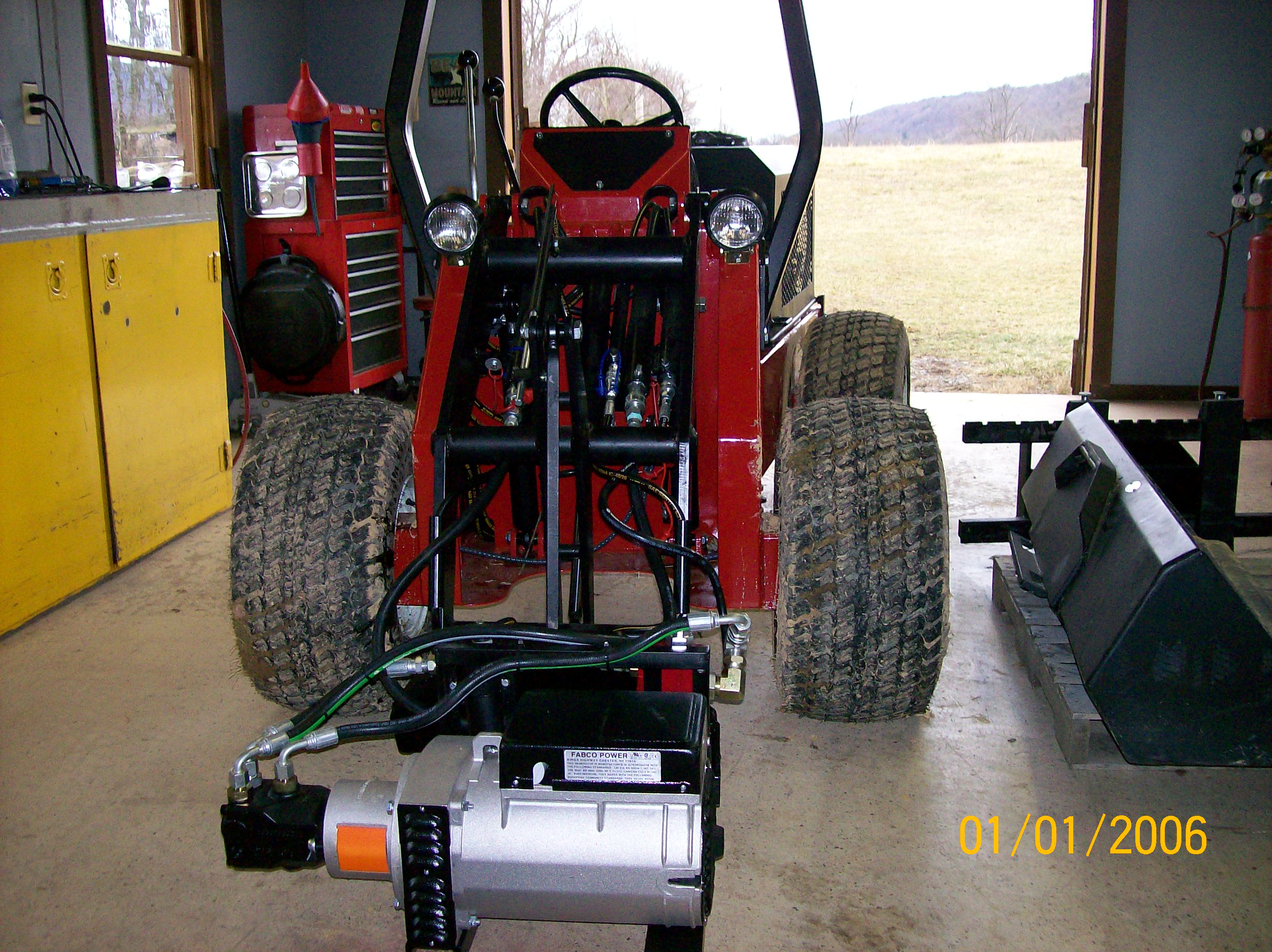

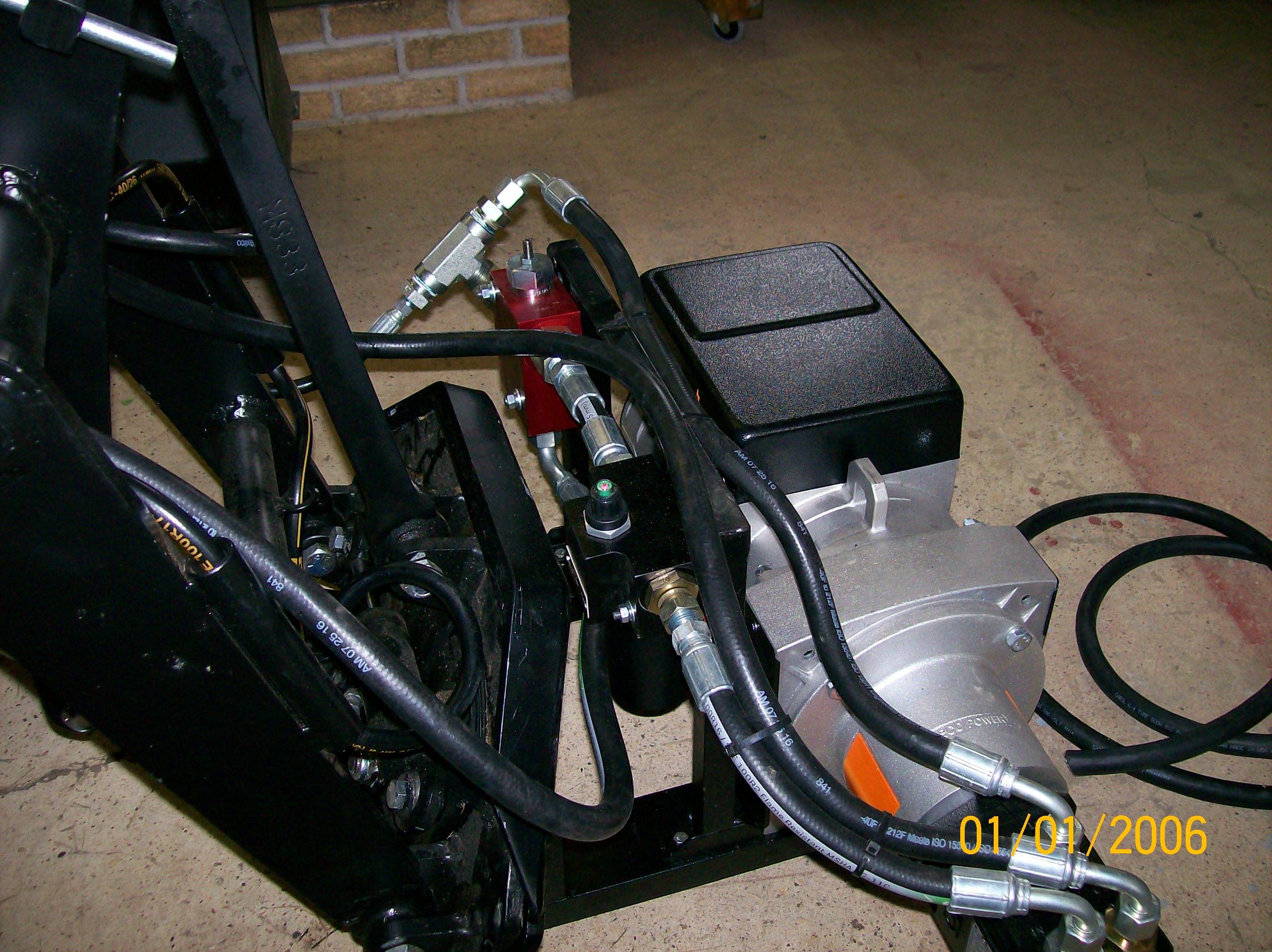

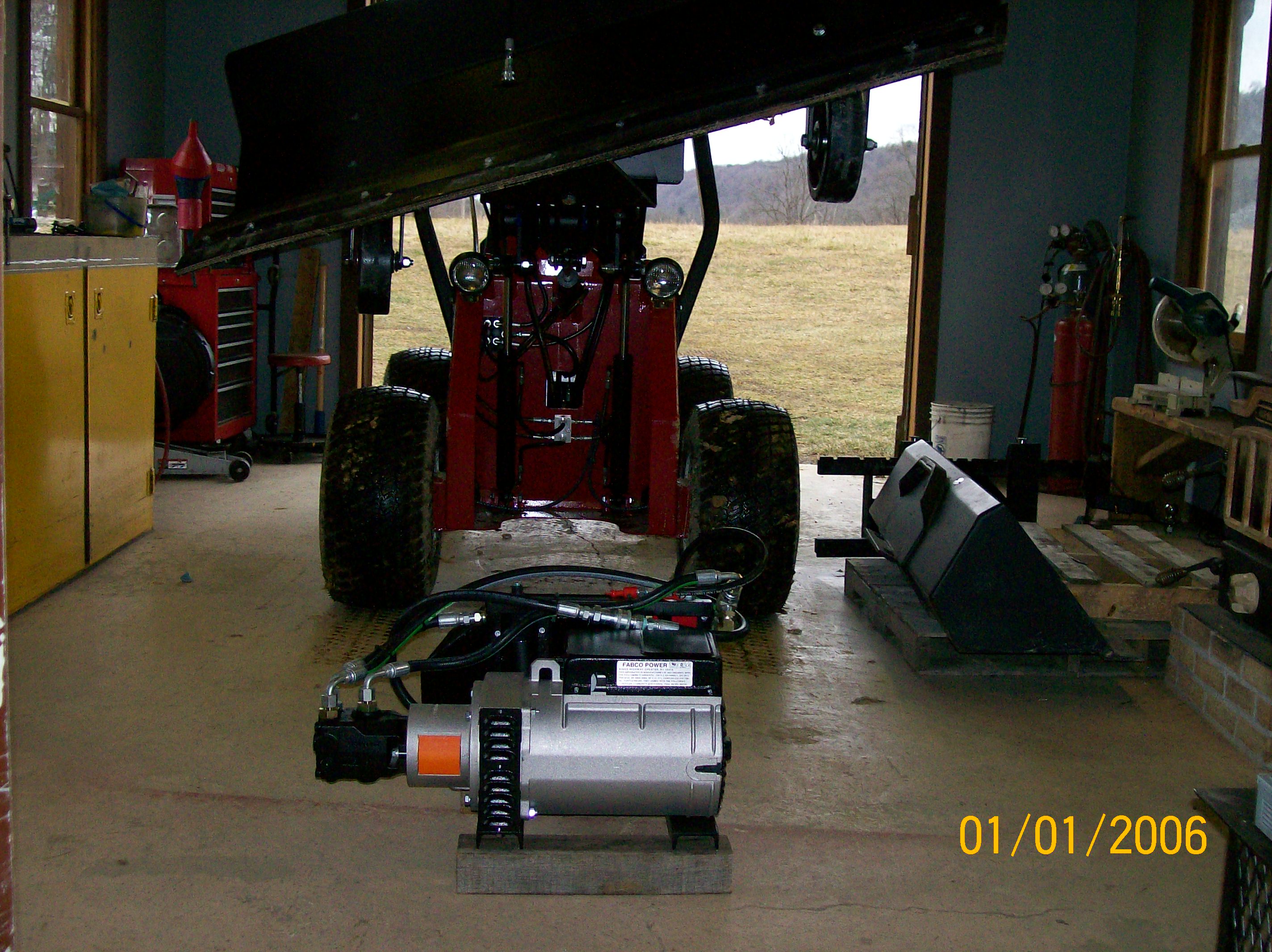

Power Trac PT1430 Year made 2016
This unit has a piston motor which is rated at 12 GPM @ 2500 psi, and puts out 12,000 watts. I have it going into a flow control valve, then to a 10 micron high pressure filter, then into the piston motor. 100_0373.JPG

I bought the bare generator with a piston motor on it, then I had to make the frame and add the QA plate. The flow control valve and the high pressure filter were really expensive. Just those two things were around $800, the bare generator/ piston motor was $3000, and the hoses/fittings/couplers were around $400, the 2 pole 50amp circuit breaker was around $40, I forget what the 6 awg, 4 strand wire and plug cost. I also bought a Hz/ V meter that was only like $15. In my opinion its not as practical going and doing all of this, compared to just going and buying a gas or propane generator.

I know exactly what your saying! What I learn is from all of you on here, and Terry told me how to make it work with the generator. I'm all by myself around here, as far as learning hydraulics goes. This PT-1430 is basically my recreational activity, so its a enjoyable learning experience, all though my mess ups can be mighty expensive.:laughing: As far as it keeping steady voltage, when you check the voltage with the multimeter, the number of volts stays without fluctuating as long as the engine is running smooth. Now, I'm going to hook up the Hz meter tomorrow. Do you have a shaft drive generator for your Kioti or Kubota?
Thats a good question, BigCountry. From my way of thinking, since the PT would be running the PTO but not the wheel motors, the hydraulic system would be creating more heat from mowing grass / bush hogging because of running 4 wheel motors + PTO. The nice thing with this is that I won't have to drain the carb, clean it, replace dried out fuel hose, and worry about about whether or not it will work when I need it.
