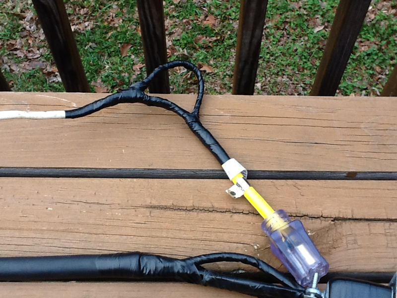

A couple of years ago during a power outage I was curious as to how much current was being put out by the generator. No big loads such as the well or hot water heater were running and most of my lighting is florescent. So, one leg was 4 amps and one was 1 amp. This kinda surprised me in that is was so low. Has anyone else measured their loads?
   / Generator load during "normal use" #2
I test every one I install and have never seen over 25a per leg.. Yours is about normal..
I made some cables to use with my clamp on amp meter for the 120 and 240 volt generators

For you to have different currents on different legs you must of had 2 cords plugged into the generator ( or 120/240 plug or gentran type of panel ).
Craig, thanks for your analysis. I thought my loads would be higher. What bothers me is that we have to size generators to start the motor loads because of the huge starting currents of these motors. Then most of the time a much smaller generator would do. I think it would be interesting for people to post what they see for actual loads to help others size generators.
