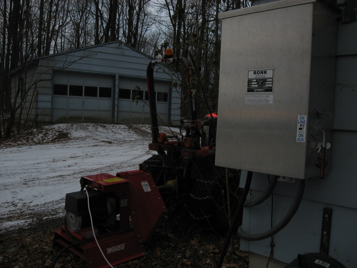

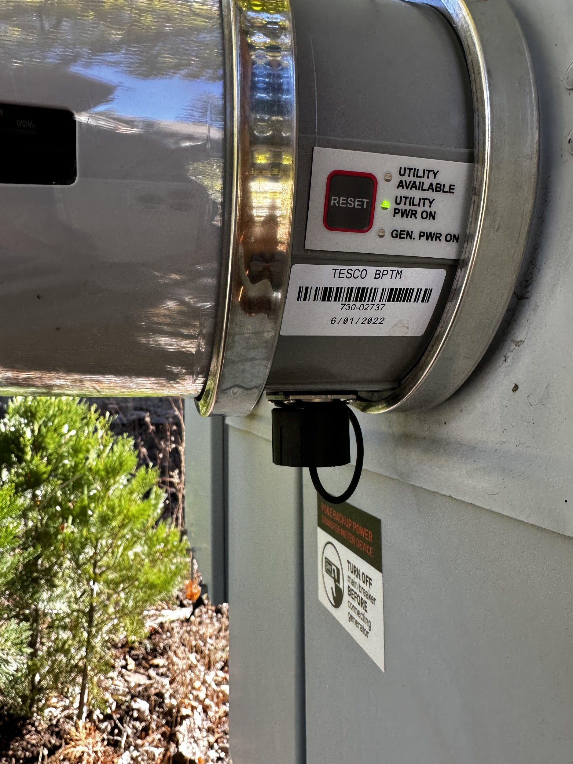

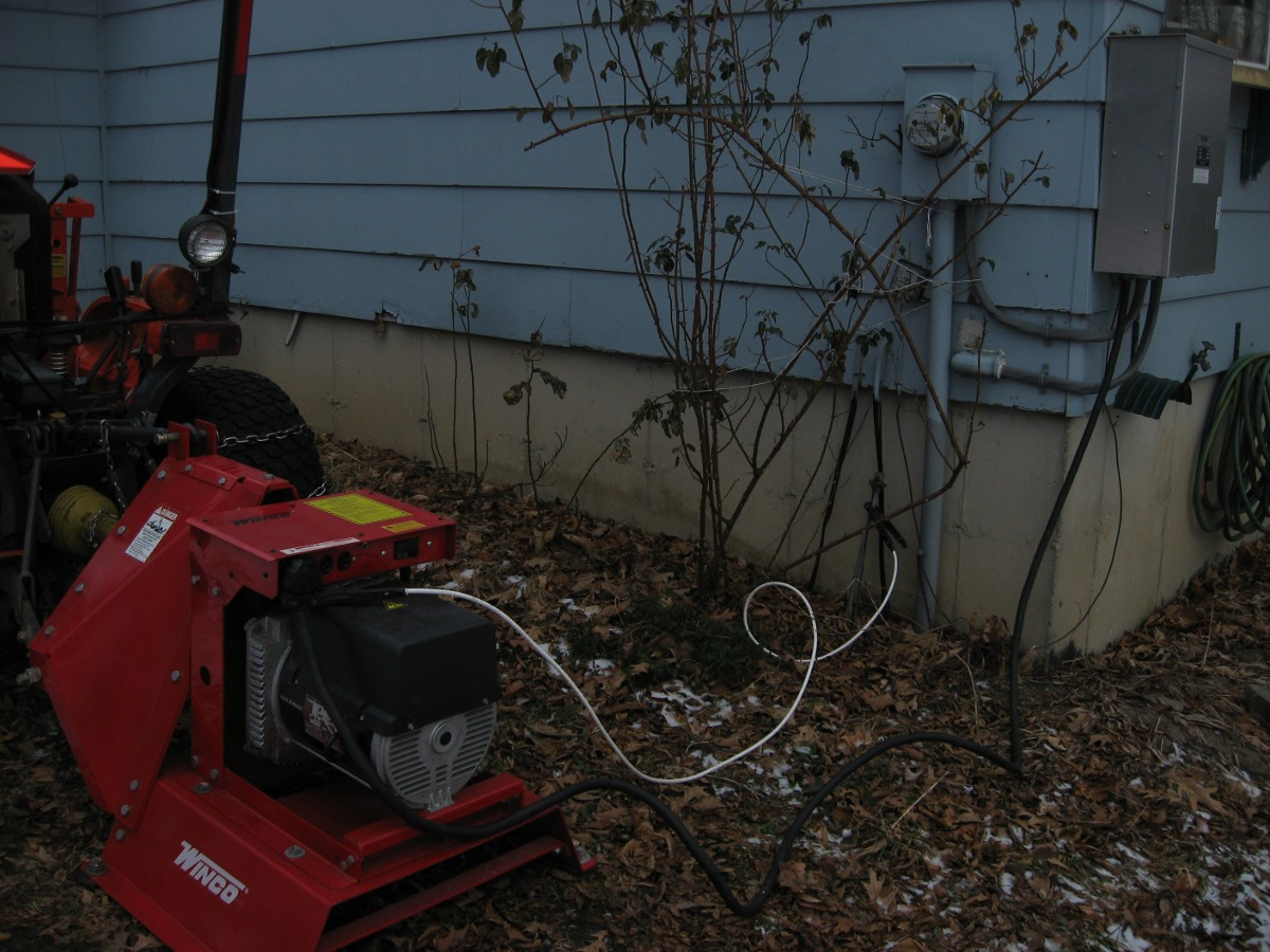

on the mains , add a light bulb pigtail that shows that you have power on the mains (it is wired before the breaker so you can see incoming power from street)
So when power goes out you turn off your main disconnect
{light bulb is off , it's on when you have street power}
generator on ....
power comes back on {light bulb comes back on} turn off generator then turn mains back on .

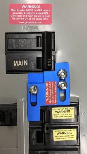

As long as you never have generator running and pigtail light is on with the mains turned off
you will never backfeed to the street
So light off main off run generator
light on main on generator off
