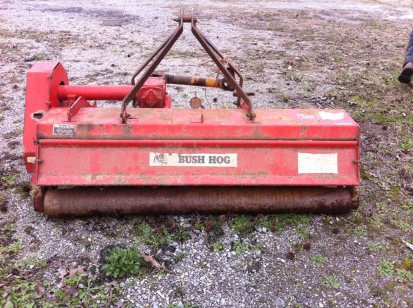

Here is a pic of it... no model # visible on the decals as they are too faded to read..... there is a stamped S# tag on it though. It has a couple of cracks in it that will need welded up and I think im going to move it over to the offset position and give it a try 3k93K33M65L45Gd5Hfd2k0f89f2b425c71257.jpg
