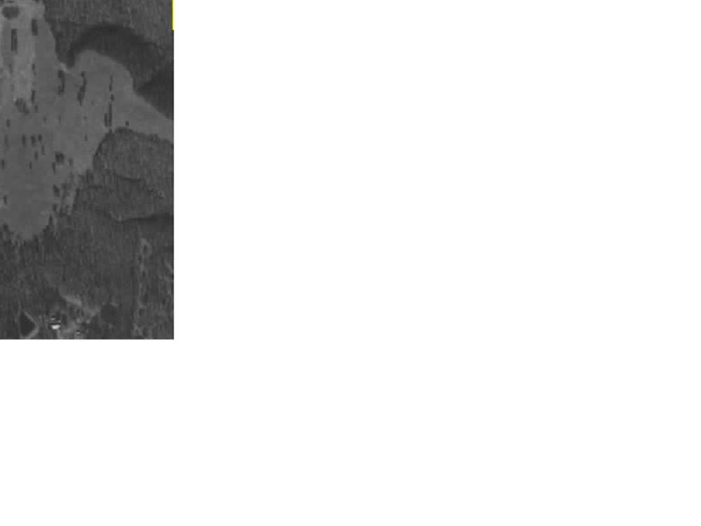

1000 Lbs of tire ballast would go a long way to evening the score. My hay guy says that I will have a bale stuck on a spear on the rear, and this will work perfectly. A lot of guys use even smaller tractors, but they don't have my terrain either...
For now, I am keeping the Supersteer out of the equation. I suspect that I will end up with it. I'm sure if you looked at the arial shot of my property, you'd think I'd be nuts not to...
