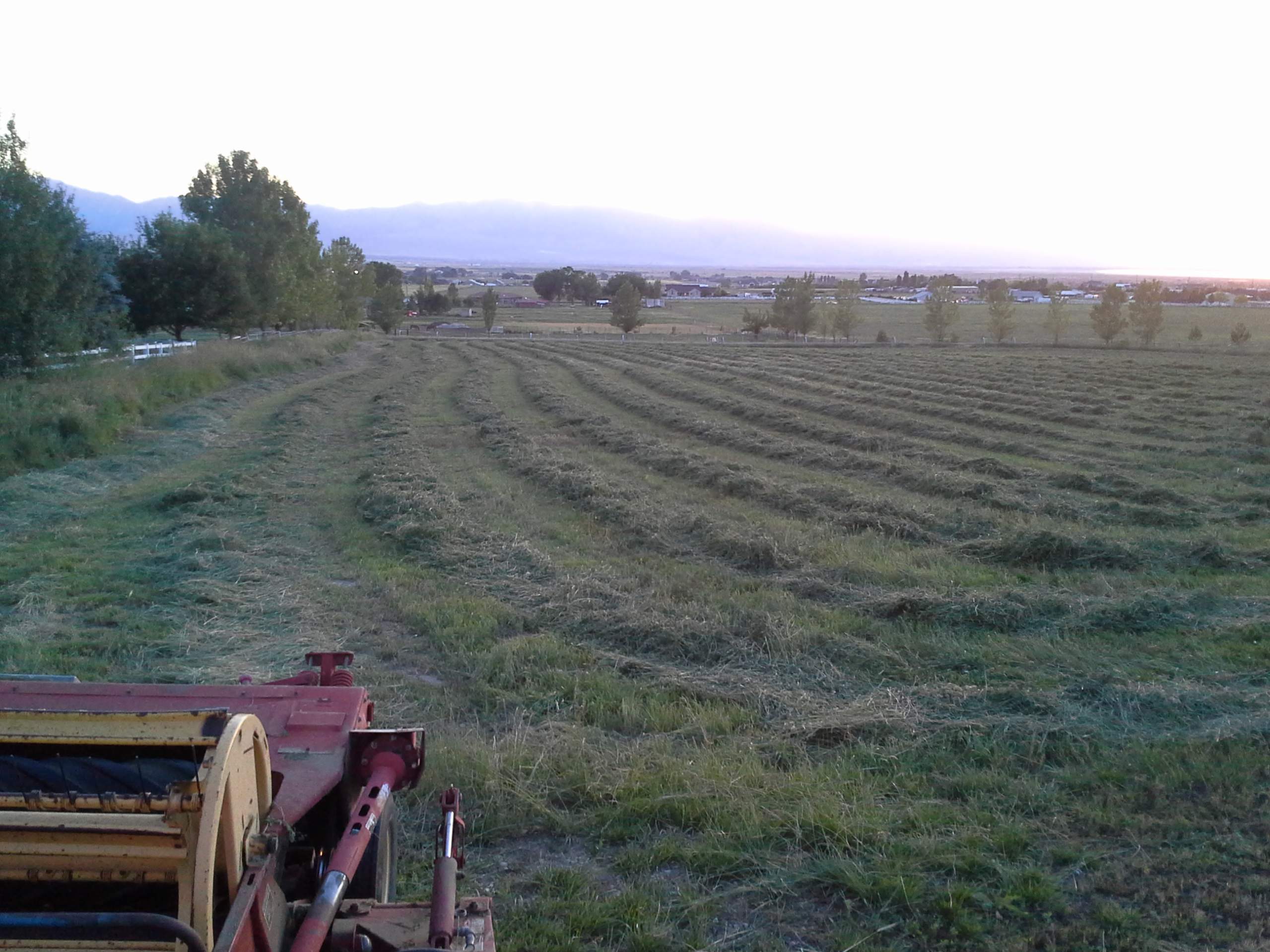

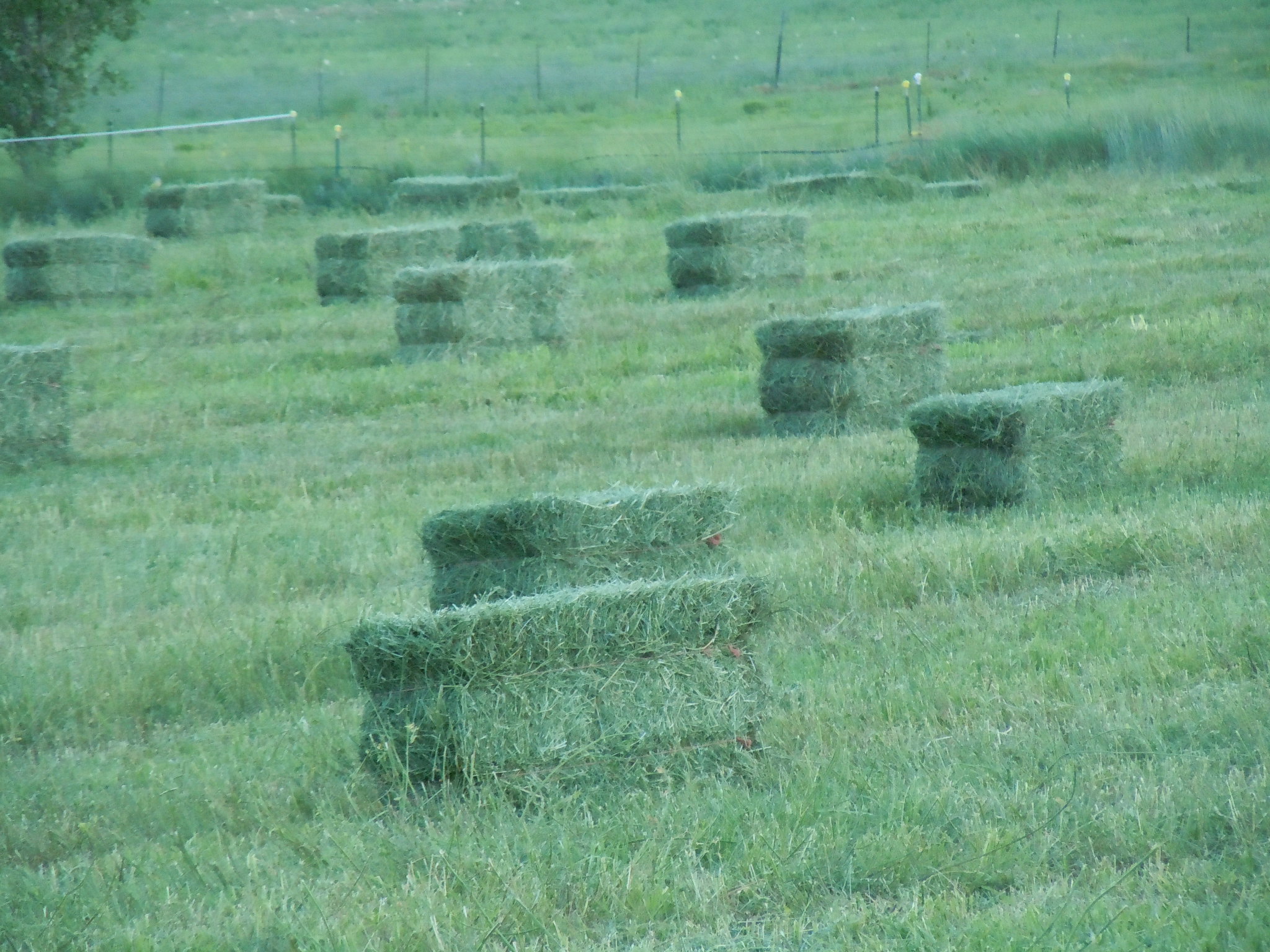

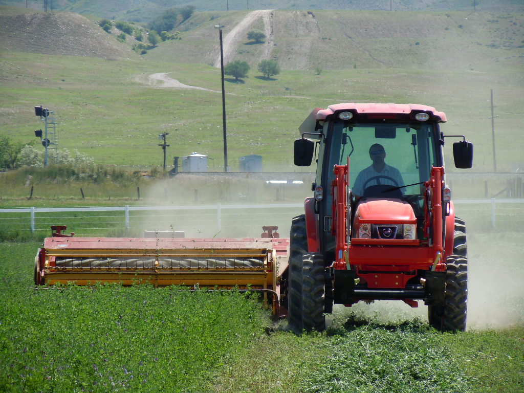

I don't think so. There have been a few thread's just like this one. There are several things to consider and only you can answer them. I was in a similar position as you last year. I had no equipment at all. I now have everything I need. (except rake and seeder) and am very happy with my decision to get into haying. :)
Here's a little something to wet your appetite.
