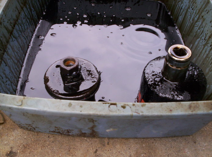

Tried to get drain plug out of old JD 950, but the head is rounded off and plug seems really seized.
Has anyone tried to drain oil from an engine by siphoning or pumping it out? I had a car mechanic (MB Dealer) that told me they vacuumed the oil via dip stick tube.
The box wrench (19mm) and socket both continued to round off the head and I could not get vice-grips on tight enough.
Any help or suggestions would be appreciated.

in most cases. easiest way is to simple dig up a big hex nut and just weld the sucker to the drain plug. the heat helps unseize it. plus gives you perfect flats for a wrench/
other options include filing or grinding the plug head with some paralel flats to fit a standard size ( no crescent wrenches.. they HELP round off heads ).
lastly. if a flanged bung , a chissle driven into the flange side , usually can be used to spin it around. can use an air chissle too.. just stay out of pan metal...
for the true evil ones. drill the center out, and keep drilling till it's 90% thru.. then weld that plug on.. ir use a punch and crush it in upon itself.
all them work. used each one many times.
I used to try to monkey with pipe wrenches and jacks to hold the pipe wrench.. I now jump right to the weldanut method. it gives success in all but the most stubborn situations.
after removal. do yourself a favor and replace the plug. unless the 'weldanut' job is particularly elegant.. then you can grind to finisht he welds and paint up. ;) ( BTDT too :) )

here's an xample.... :) just to prove i'm not 'armchairing' this. ;)
   / Getting Oil Out of Engine #9
in case it is not clear, item on left is a drain bug with wide flange with a hex nut welded to the rouded nub on the plug. onthe right is a spin on oil filter laying in the drain pan, with a socket laying on it. probably the one that fit the nut.. or maybee one I thought fit it and set it there while fiding the right one.
