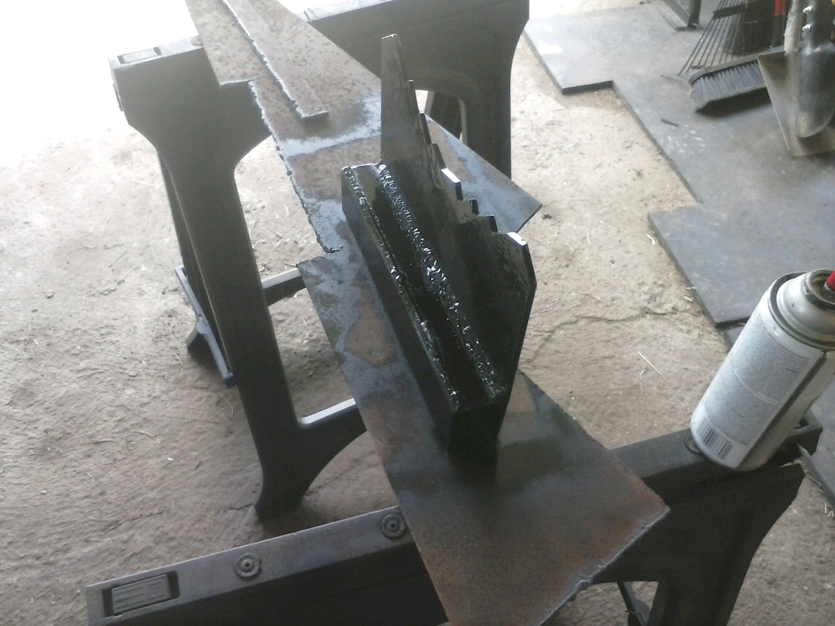

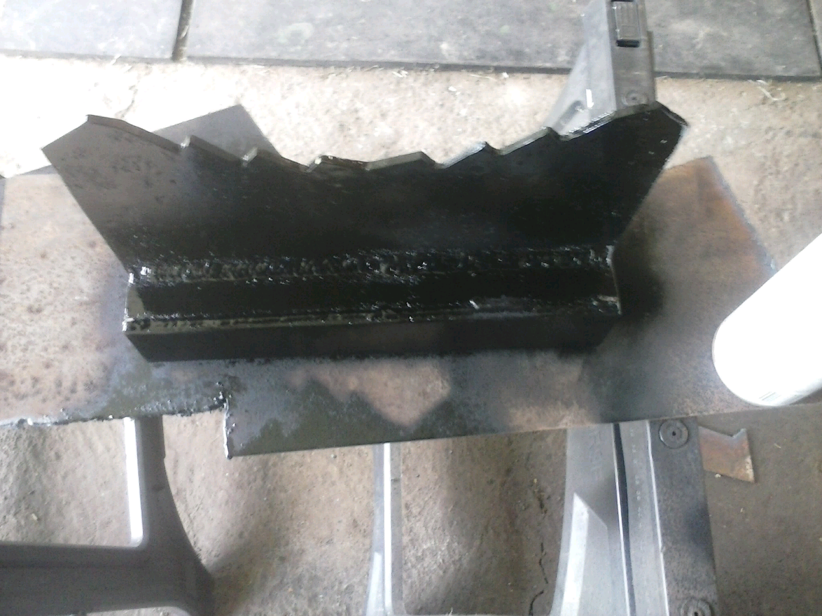

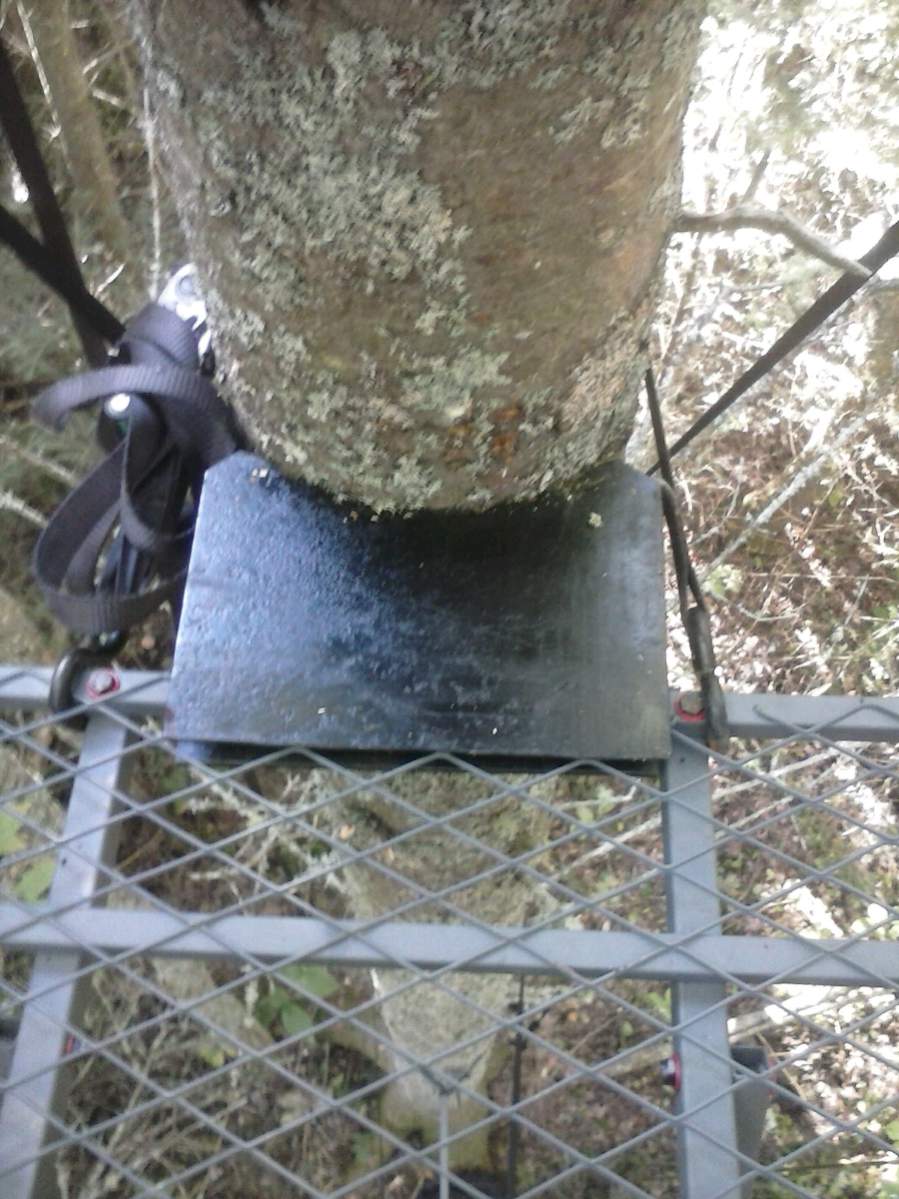

Been out in the woods setting up my tree stand for the past couple of days and cutting shooting lanes for the bow. Ran into an issue with my new 2 man stand. It had tree teeth behind the seat, but none on the platform, resulting in a wobbly mess even when tightened as far as possible. My solution? A bracket made from 1/4" steel with teeth for the tree. Makes a rock-solid platform now:

Good fix to that stand.
I have several metal ladder stands, some with teeth on the platform and some without. I like the ones with teeth better, but did have a problem with one trying to fit it to the tree I chose...the tree had a hump right where the bottom teeth fit, so then the top teeth would not fit tight against the trunk. It was then that I guessed the reason why some have only top teeth. I still prefer teeth on both.
