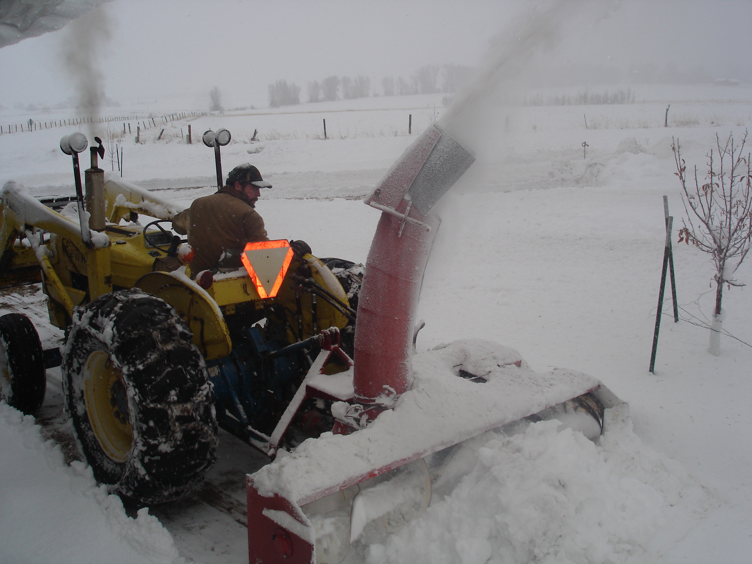

This reminds me of when I rebuilt my McKee blower a few years ago. I also had to reline the impeller housing though. It was worn out from 30 to 35 years of blowing a gravel road.
Something you might consider doing, it looks like your blower has a flat plate at the top of the shoot. Find some thin wall pipe, split it and weld it to the flat plate. I did that with mine and it sure made a difference in how far it would blow the snow and how much loose snow was blowing back on me.
Are you saying eliminate the corners, as shown in red?
Yup, but I opened the pipe up so it carried up the sides too. The snow was traveling up the shoot, hitting the deflector and deflecting all over. The pipe kept it more contained so it was a smoother transition from the shoot to out the end of the deflector.
