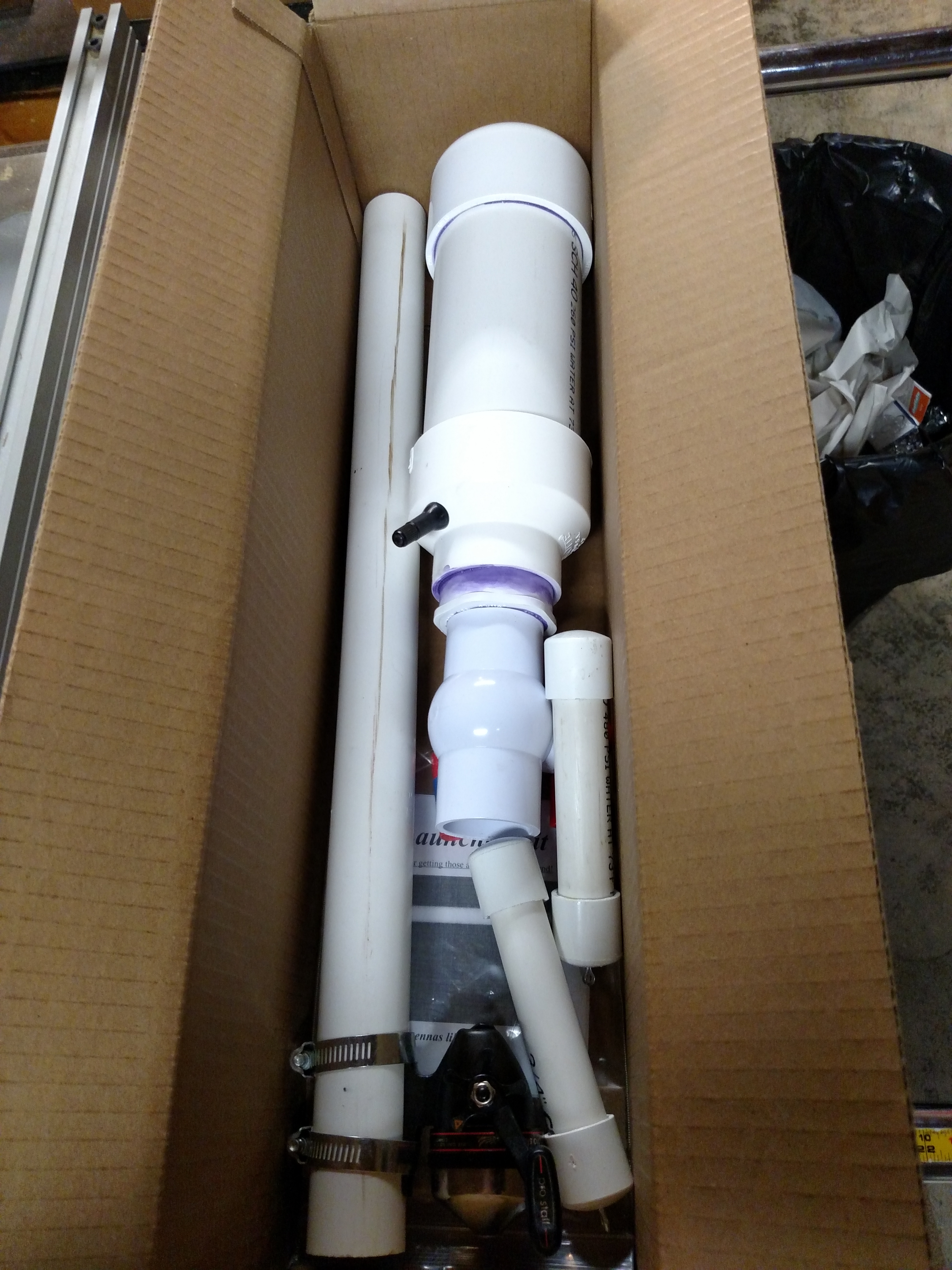

I bought this pneumatic launcher kit a few days go at local hamfest. As an amateur radio operator, we are always wanting to get a string over a tree to pull up wire antennas, but some of you may also have some other application to get a rope over an obstacle of some kind. Let me tell you this thing really works. Sure you could build one yourself, but as the Club that was selling these stated their release valve is much easier to turn than the ones I saw in home depot.
I put 30 lbs of air into it and it shot the pvc "bullet?" over a 60 foot tree and over another and landed about 80 feet downrange while trailing the fishing line from the reel. I think you could fairly easily get a line over a 100 foot tall obstacle.

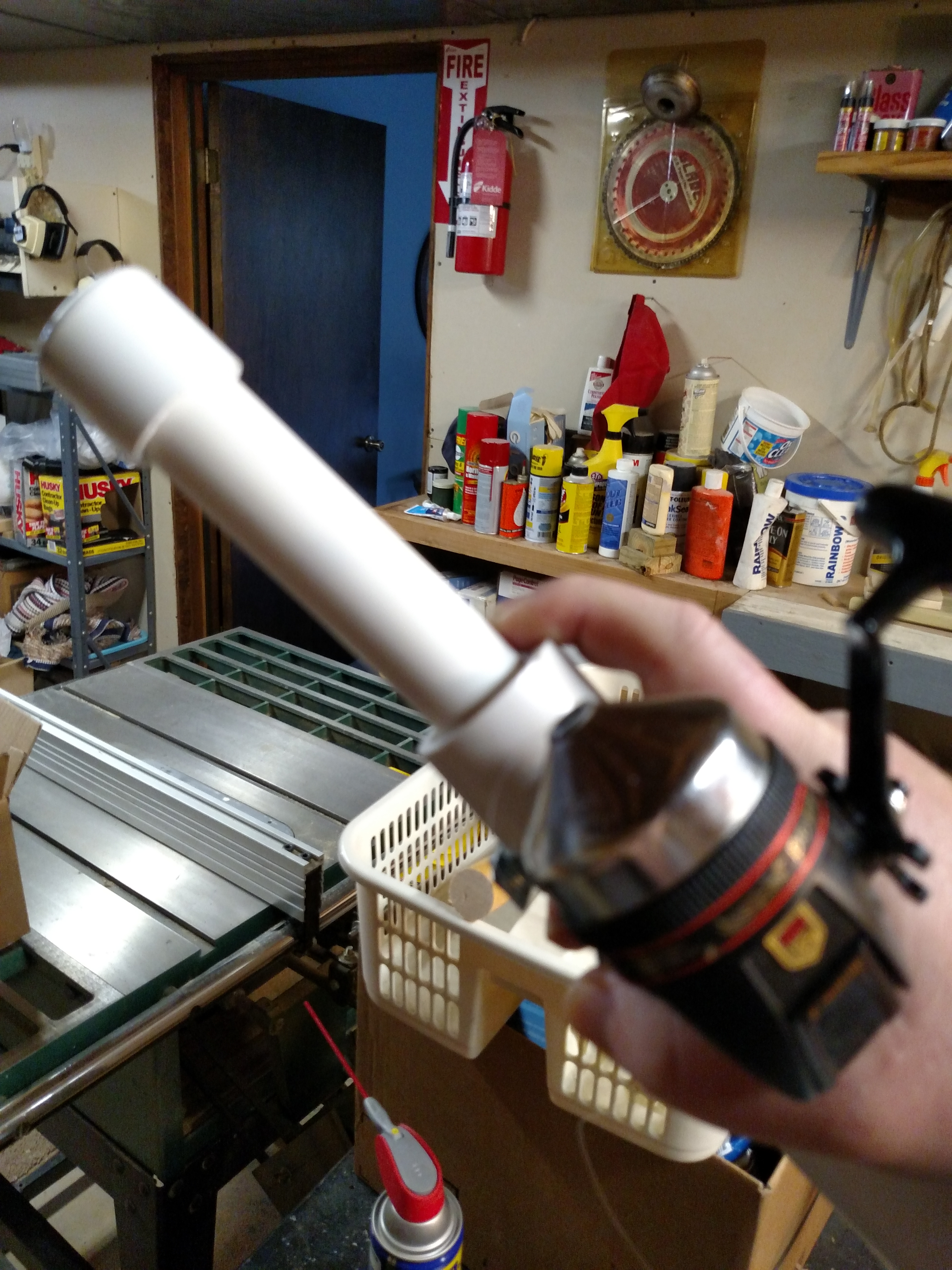

As per their recommendation I did not glue the barrel into the valve as this makes it easy to store back in the box it came in. to utilize, you close the valve, and charge with 15 to 30 lbs of air thru the schrader valve. Then clip on the projectile with the supplied fishing swivel, and insert it butt first down the tube. Don't look down the tube. :shocked: It is best to load it outside, as this thing is no toy. Point the barrel at the desired spot and open the valve rapidly. This is much like and almost as much fun as firing an RPG (I think :)) Anyway the "rocket" comes out of the launcher tube with some authority and a satisfying sound. Remove the rocket on the other end and clip on your string/rope and haul it in with the reel.

More or less, but just air powered. But if you put some weight inside the "rocket" and charged to to say 90 lbs.. It might kill from blunt force trauma at close range. I sure wouldn't want to get hit with it. The empty PVC rockets move pretty fast at 30 lbs of pressure.

This one works pretty slick. The secret is getting a good easy to turn all at once valve. I don't know where they are getting their valves, but the guy said they mail order them and most of them are fairly easy to turn. He said they send back the few that aren't. The one I tried yesterday at Home depot was considerably harder to turn.
