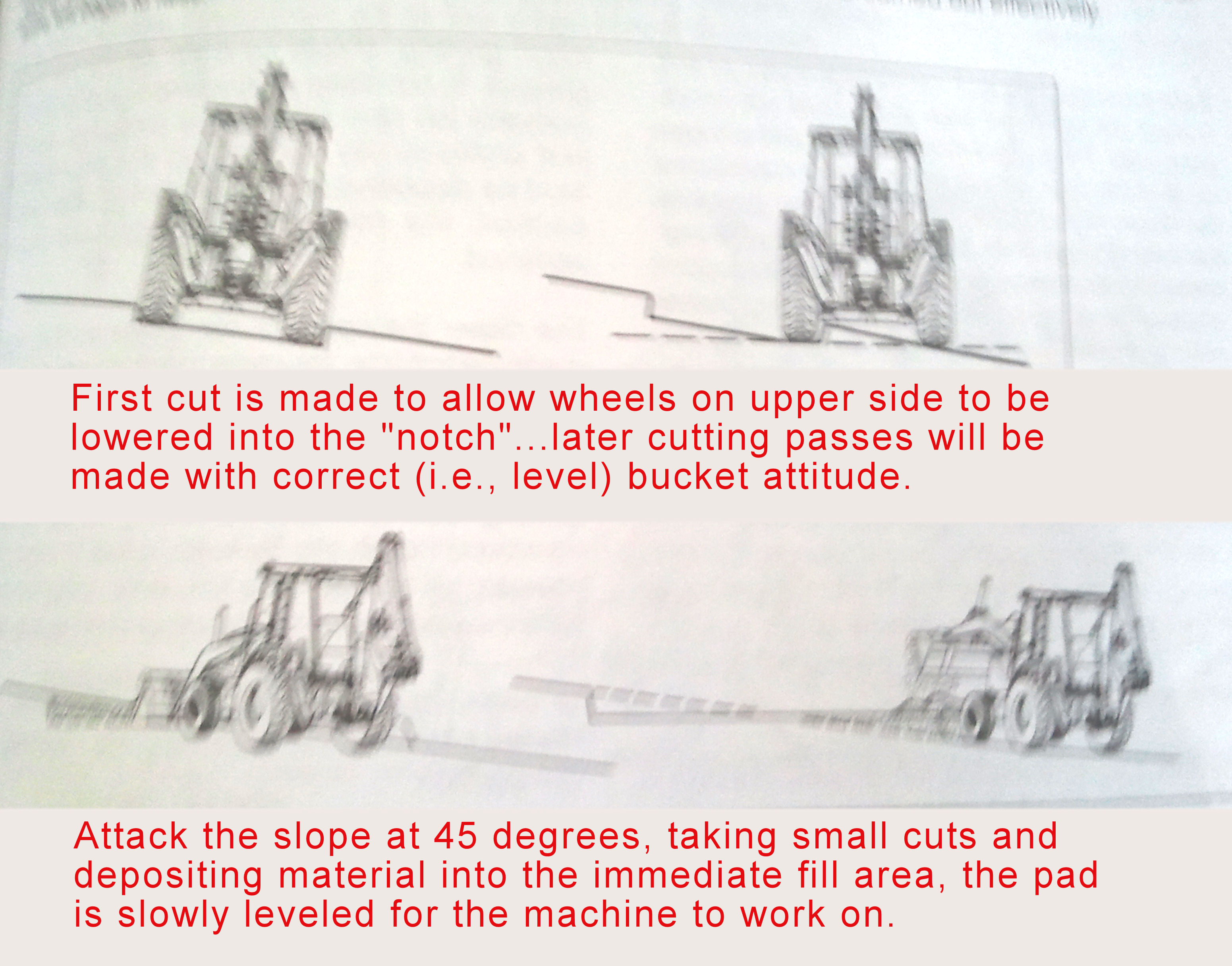

Hi all, I have a BX23 tlb, and in my short experience I have a very hard time getting stuff level.
I seem to be able to replicate whatever angle the tractor is canted at, but feel I am lacking a one-sided 'tilt' for the loader bucket so I can cut in at an angle other than the one the tractor wheels are currently at.
At times I've wasted a lot of fuel building a flat runway (from the perpendicular or with the backhoe) so could go back and cut flat.
I ask becaue I'm getting ready to make a gravel road at the new farm (rather than just small projects at the house), round 1000 ft in fresh, rolling hills.
What am I missing here?
I'm thinking a rear blade would give me angles fairly independent of the tractor angle, and then be useful later for snow. Once I cut a track 'flat' I could turn around and move the excess/lack back and forth with the bucket, and work the final height from a wheels flat stance.
Do I have an equipment problem or an operator problem?
Thanks all.

There is a good book on TLB operation ("Operating Techniques for the Tractor Loader Backhoe, Gary Ober) that discusses two ways to get a level with a fixed loader...each involves initially making a level pad/stance for the wheels ...a little hard to picture in words:
(a) take a cut across the slop (across the "fall line" for you skiers) ...this cut will be aslant, but now back up and just put the uphill two wheels in the cut you just made and (if you made it deep enough) you will find the tractor level ! Now do your normal cutting and moving the spoil.
(b) attack the slope at an angle to the fall line so that the tractor bucket is level side to side (yes, there is such an angle) and take a cut, removing material and depositing it downslope from your cut ...widening the "bench".
attached is a crummy pic that may help ...but I urge you to buy the book HEAVY EQUIPMENT TRAINING MATERIALS: Equipment Training Resources - Backhoes, Loaders, Excavators, Trenchers, Hydraulics Training Books & Videos

Thank you all, but JoeL4330: that A, that's the trick I needed!
I've worked so far where I only had a single extra side, up beside the house, etc., and traveling uphill of my work area hadn't hit me - that's a beautiful technique! I bet I could even rig up a depth gauge for that first pass.
