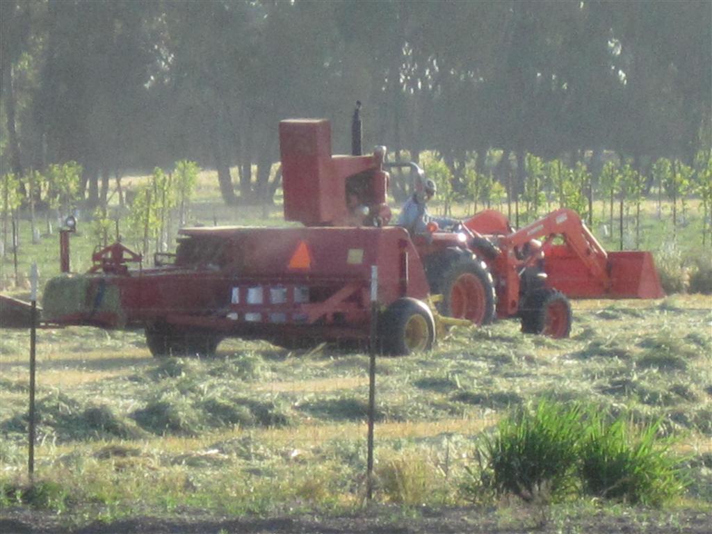

I would add that you should include self-powered balers in your shopping quest. My neighbor bales about 8 acres of oat hay using one of these. He pulls it around his hayfield with his Kubota L4400. The baler is powered by an on-board 20 hp gas engine that drives the baler via triple V-belts connected to the baler flywheel. It's a three-twine type that produces 100-120 lb bales. You may want smaller bales (50-60 lb) in which case a 2-twine baler like my pto-driven Massey Ferguson 124 might be the right choice.
Good luck

That's a slick baler flusher.
A lot of the older balers (I would stick with NH or JD due to some parts still being avail. through dealers) have a really large oversized flywheel on them. They are usually a little bit of work to get the baler initially rolling but once started the centrifugal force will help keep the baler moving along with lower demand from the tractor.
There are vids on youtube with people baling with 8n's, MF 35's and other small gasser tractors with much less Hp and a much lower torque curve than your Ford so that shows it definitely can be done. If you find a baler you like research it a little on youtube than go to tractordata and see if your tractor has equal or greater horsepower. It's a great way to avoid buyers remorse on getting an implement too large for the tractor to handle.
