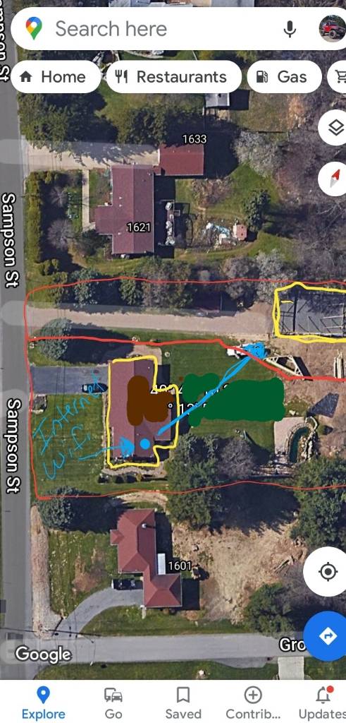

If you run ethernet you can have a mesh system. The automatic handoff is great to keep your phone from hanging on to weak signal.
If you run an ethernet cable why spend the money on a Mesh System. Just plug the ethernet cable into the computer and the other end into the router at the house.

Cell phones and tablets are typically wifi only. I assume any shop internet would be mobile computing based. I have an office in my shop, but still have a wifi router so I can access the internet on the shop floor.

I deal with idiots day in and day out that just don't get the difference between wired and wireless speeds. If at all possible, run a cable to the out building. If you need wireless then put in a wireless router in the out building.

Does the existing cable line in the barn go to the house? If so, I'm thinking you could do ethernet traffic over the existing line using something like this.
Amazon.com: Actiontec MoCA 2.5 Network Adapter for Ethernet Over Coax (2 Pack) – 1 Gbps Ethernet, Coax to Ethernet Adapter, Enhanced Streaming and Gaming (Model: ECB625K2): Electronics
If you introduce another cable modem to your setup, that would require interaction with Spectrum to get them to communicate with it. I don't know if they would charge.

What I failed to mention is that the service drop cable is our utility pole. At this point it "T"s off. One for the house and barn. So the cable at the barn is still hot.
just really, really want to avoid paying for what will be occasional use.
Going to look at this as posted earlier- TP-Link 2.4GHz N300.
If, a big if, it fails to perform (metal barn) then I will relent and call Spectrum about their policy on running two modems in one account.
