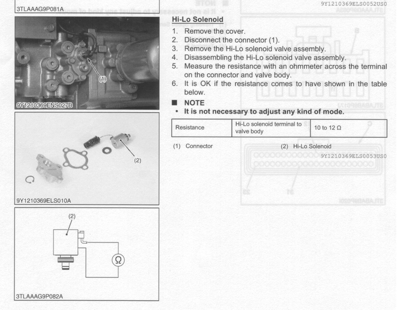

Hi,
I have the same tractor, so I looked in my WSM. On page 9-S11, I find:
Trouble Item:
Hi-Lo solenoid failed
Probable Cause:
. Hi-Lo solenoid output terminals voltage is out of specification.
. Hi-Lo solenoid broken or short-circuited.
. Wiring harness broken or short-circuited.
Solution:
Engine does not start (This is a solution ????)
Check the Hi-Lo solenoid resistance (Page 9-S51 shows 10 to 12 ohms)
Replace the Hi-Lo solenoid
On page 9-S51, there is also a small photo of the solenoid's location and a related parts. It's near a filter, but I cannot tell where (My 20 hour 5240 is at the dealer with a MAJOR hydraulic problem.) I'll scan the WSM photos if you think that will help, but your dealer can probably tell you where the solenoid is located if you are able to measure the resistance.
Hope that helps.

It looks like an easy replacement to me. Your dealer may get you the part under warranty. Mine had Kubota next-day-air a valve directly to me under warranty (very accomodating dealer).
I have attached a scan of the part of the manual page showing the solenoid

Didn't think of that, but it is worth asking about. (As desperate as they seem to be for work these days they may want to have it in house though in order to bill Kubota for the repair.)
Obviously, the code is what it is. However, this picture looks a bit different than the one I suspected as being the problem. I will take a closer look, and may post a picture for you to see.
