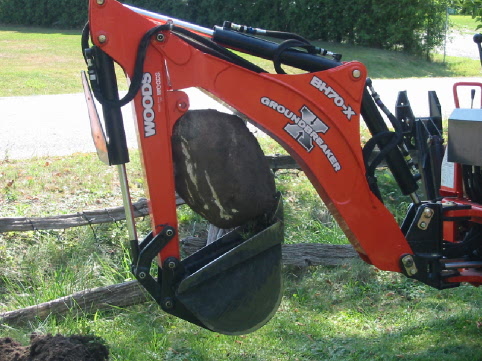

A couple of months ago I was caught up on projects so I lent my tractor to a friend who had some work to do fixing up his barn and getting it ready for horses. Since he brought the tractor back last night I thought I'd use the hoe instead of a shovel to pop out a rock that I kept hitting with the lawnmower. Boy am I glad I had the hoe back- turned out to be a lot more rock under the ground than I could see. Took about 2 minutes to get the rock out and 10 minutes to go back to the fence row and get a bucket of dirt to fill in the hole. Now I have to start looking for little projects again.

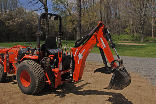

WOW, you lent out your B7800! I don't think I can ever bring myself to do that. You machine is excellent. I also have the B7800 with the Woods BH. The BH is a great attachment, very happy with the Woods BH-70X. The thumb is a nice feature as well. Here are a couple of photos when I was clearing some property to make my lawn bigger so I could use the MMM.:D

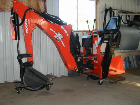

Somehow the thumb and bucket together look like hungry pelican.:D When I lent my tractor out the only job I'd done with the new hoe was to dig a hole to bury our aged (31 yr) horse. Now my buddy has more experience with it than I do. I took it off today just to see how it would go and it seems to sit pretty solidly on a couple of those el-cheapo car wheel dollies from Princess Auto. Also, with the extra height of sitting on the dollies, I havn't had to remove the 3 pt hitch arms when mounting or dismounting it.

I like the dolly setup for ease of maneuverability of the BH while off the tractor. I have seen the dollies at Harbor Freight as well. Is this setup stable?
Thanks
   / Glad to have my B7800 home again

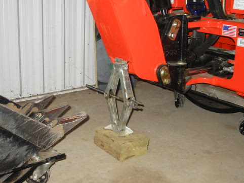

Yes, it seems very stable. I tried rocking it and it seemed pretty solid, and then I wheeled it about 10 ft to where it's sitting now. I put a piece of 2 x 12 plank across the dollie that has the main frame sitting on it and positioned it just ahead of the stabilizers. Because the main frame is sitting up on the plank and the bucket is down in the dollie I had to extend the boom slightly to get it to sit level. With the boom slightly extended, I couldn't do up the transport lock, and since I'm not sure if it will sag over time without the transport lock done up I've put a scissor jack under the boom just to be safe. Hope this helps.
