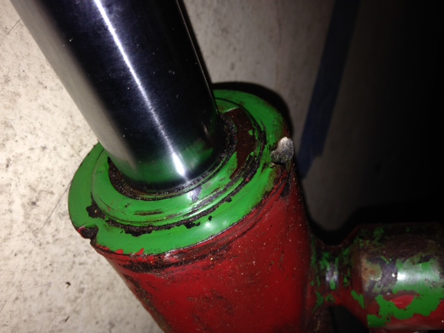

securedownload 1.jpgsecuredownload.jpgok Brian, here you go , I took both off the front end loader bucket, but I cant get the cylinder to come out to repack them...any ideas..thanks
   / gland removal tool #8
Look for a set screw in the side of the barrel about a 1/2" or a little more from the rod end of the cylinder. Remove it, and using a soft punch or drift, drive the gland down into the barrel an inch or two. Remove the internal retaining ring from the I.D. of the barrel. Using the rod and piston like a slide hammer, remove the gland, rod and piston from the barrel all together. Before you start any of this, clean up all the dirt, oil and garbage from the exterior of that cylinder. If you are going to accomplish successful repairs, you need to learn how to be clean. You can't fix cylinders with that much crap hanging off them and expect them not to leak when you get done.

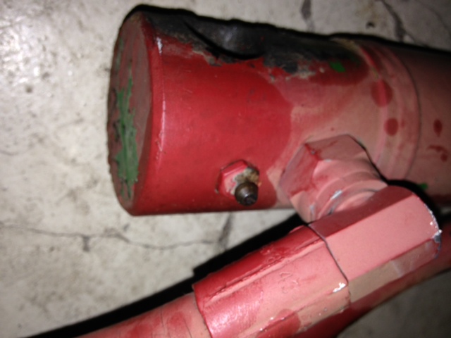

yes your right about it being dirty....there is no set screw anywhere on the rod? unless your talking about the opposite end of rod looks like a nipple for grease?

trac.jpgtrac4.jpg heres some more...a little cleaner...is this the set screw on the opp. end?
   / gland removal tool #13
You have to unscrew the nut on the end with the notches. Then drive the end of the cylinder in to remove a snap ring. Then it will come apart. Watch the video.

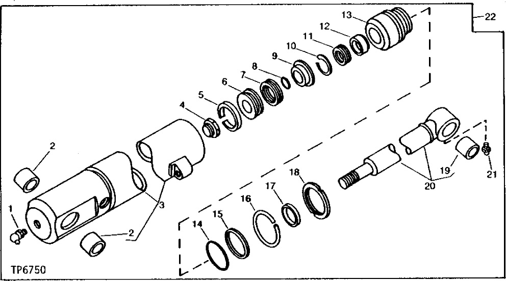

image.jpgYou may have to clean the paint off the threads on the nut, to get the nut off. If the whole end keeps turning you may have to put it back in the loader and pressurize the rod end of the cylinder to keep it from turning to get the nut off. Number 16 is the snap ring that holds it together. Remove the nut #18, drive in #13, do not damage the threads for the nut. Remove the snap ring in side the barrel and then it will come apart. #13 is held from coming out by the snap ring and the nut keeps #13 from moving into the barrel.
   / gland removal tool #17
The new seal kit comes with a orange triangle ring that fits in the snap ring groove to help get the cylinder apart. Put it in the cylinder to get it apart and install it on #13 on the threaded part before installing the nut to get it apart next time. If you watch the video you will see him removing the snap ring with a screwdriver. At the end before he puts the nut back on you can see him putting the orange disassembly ring on #13.
