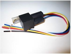

If going spring loaded toggle, also consider adding 30 amp (generic) auto relay with socket/pigtails...
   / Glow plug problem. #10
I got a heavy duty spring loaded toggle switch at the auto parts store. I think it was rated at fifty amps. I also replaced the glow resistor in series with the glow plugs. It drops the battery's twelve volts down to the (I think) 10.5 volts my glow plugs require. The resistance of the glow plugs changes as they warm up so a resistance check with an ohmmeter will be much lower than the resistance of a glow plug in use. I use four glow plugs (four cylinder engine) and I think the total draw is about forty amps. I turn on my key and look at the dash lights. When I hit the glow plug switch they do dim, but just a little bit.
