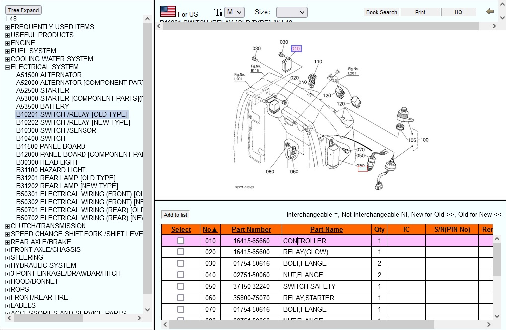

   / Glow plug question #4
My glow light was coming on, maybe going off, maybe not. Engine started fine. I read about it on OTT and TBN - symptom set seemed to point to the controller. Good guess because a new one cured it.
I bought one that was around $70 - I see they are all over the map now - some around $35, some over $200 - list here.
page from K's parts list: old and new type use same part - fits a lot of models.
