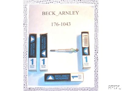

am i ever glad i read this! i checked the voltage to my glow plugs on my ts 2200 today & got nothing! turns out the control resistor is melted in two.i checked both glow plugs & both measure 1.8 ohms.any ideas where i might find something i could use? already e-mailed rainbow dist. but will probably take several weeks to get.also,i be much obliged to find out where these injectors & glowplugs can be found,thanks in advance,revg62

   / Glow Plug Questions TS1610 #7
Revg62, Try these /forums/images/graemlins/smile.gif
Rick

   / Glow Plug Questions TS1610 #8
NGK.com has Y104 which is the number for Isuzu 2aa1 engines. I crossed their number to Bosch/Zexel at a local diesel shop here (don't have the number readily availabe at the moment).
   / Glow Plug Questions TS1610 #9
thanks rjb & blenderman,good to know there are people like you that have been down that road & are willing to help.i do appreciate it! revg62
