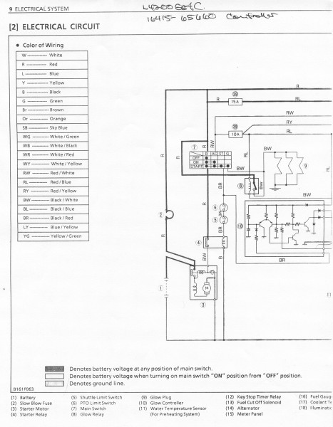

Hi Guys,
I was fortunate to get a good deal on a L35, It only has a couple of issues. The main one is electrical. First problem was a faulty alternator, after reading here I ordered a replacement from Pats small engines.
I think what caused the Alt to fail is the glow plug controls. Most of the time the glow plug light (and plugs too) stays on all the time. I think this has caused the alt to run overloaded all the time and damaged the alternator.
Today the glow plugs didn't come on untill I pulled the dash and knocked the relays a bit, now it seems to stay on all the time again.
From searching here it seems there must be a timer that is supposed to shut the glow pulgs off.
I am looking for the location of that control. It looks like there is also a Glow plug relay.
Does anyone have the wiring diagram for these and the relay/timer location?
I just picked this up this week so I don't have a manual yet-Is there any online manuals?
Once I get the information I will see just what is wrong and figuire out if I will replace the timer or just rewire it to a momentary switch I will manually use to heat up the glow pulgs thru a relay.
Thanks
Jerry

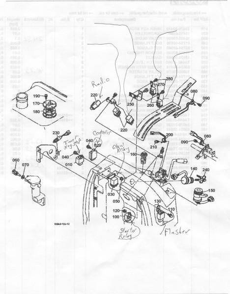

   / Glow plug wiring help needed #4
On the Grand L's (similar - maybe identical glow plug control) the starter switch is turned until the glow plug indicator comes on and then later goes off, then the switch is turned further to start.
The parts list for the L3600 shows a timer T0070-31410 ($72) and a controller 16415-65660 ($62) These two are mounted back-to-back to the glow plug relay 16415-65600 ($26). All three pieces are mounted with 2 bolts inside the body behind the dash panel on the right side. The coolant temperature sender on the engine might be the problem - 16415-83040 ($23).
Depending on what's defective, a simple glowplug/starter switch without any relays or timers might be a cheaper fix. The older Kubota models used a simple 3-position switch to send power to the glow plugs and/or the starter. The L345 switch is 37150-32200 ($35) plus knob 37150-32210 ($5) - It is wired direct to the glow plugs in one position and in the other it powers the starter circuit too. (On these models the glow plugs also get power whenever the starter runs)
Kubota parts lists are available by email from Tractorsmart.com

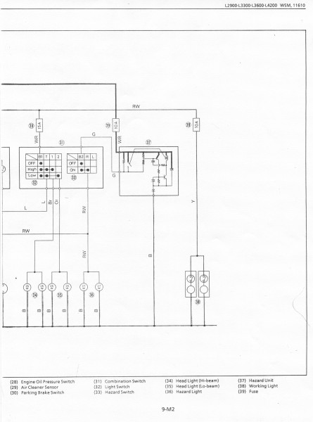

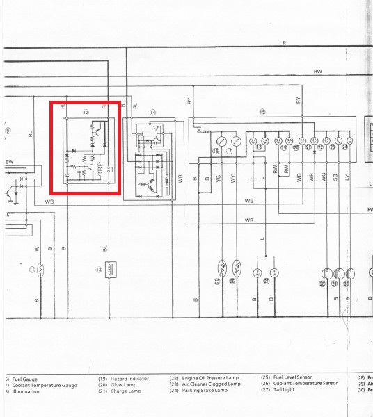

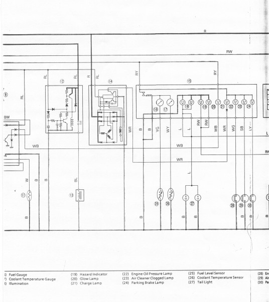

   / Glow plug wiring help needed #6
Jerry...
This is the layout on Grand L's. I think rbargeron is right, should be the same...
I reduced the file sizr so they will fit. KennyV.
Just a follow up to say thanks for you guys help. The glow plug controller was faulty. I decided I would rather have a toggle switch to control the glow plugs with rather than a new controller.
I picked up a 3 position toggle switch (one position is momentary) DPDT plus a weather cover ($17 total) and with the help of KennyV's wiring diagram wired it in a Auto-Off-Hand configuiration.
Auto- leaves all in original condition
Off- drops power to the glow plug control
Hand- (momentary) drops power to the glow plug control and completes
ground circuit to glow plug relay to operate glow plugs
Works great and someday when I pick up a new controller I can just change that out and it will work normally if I want.
