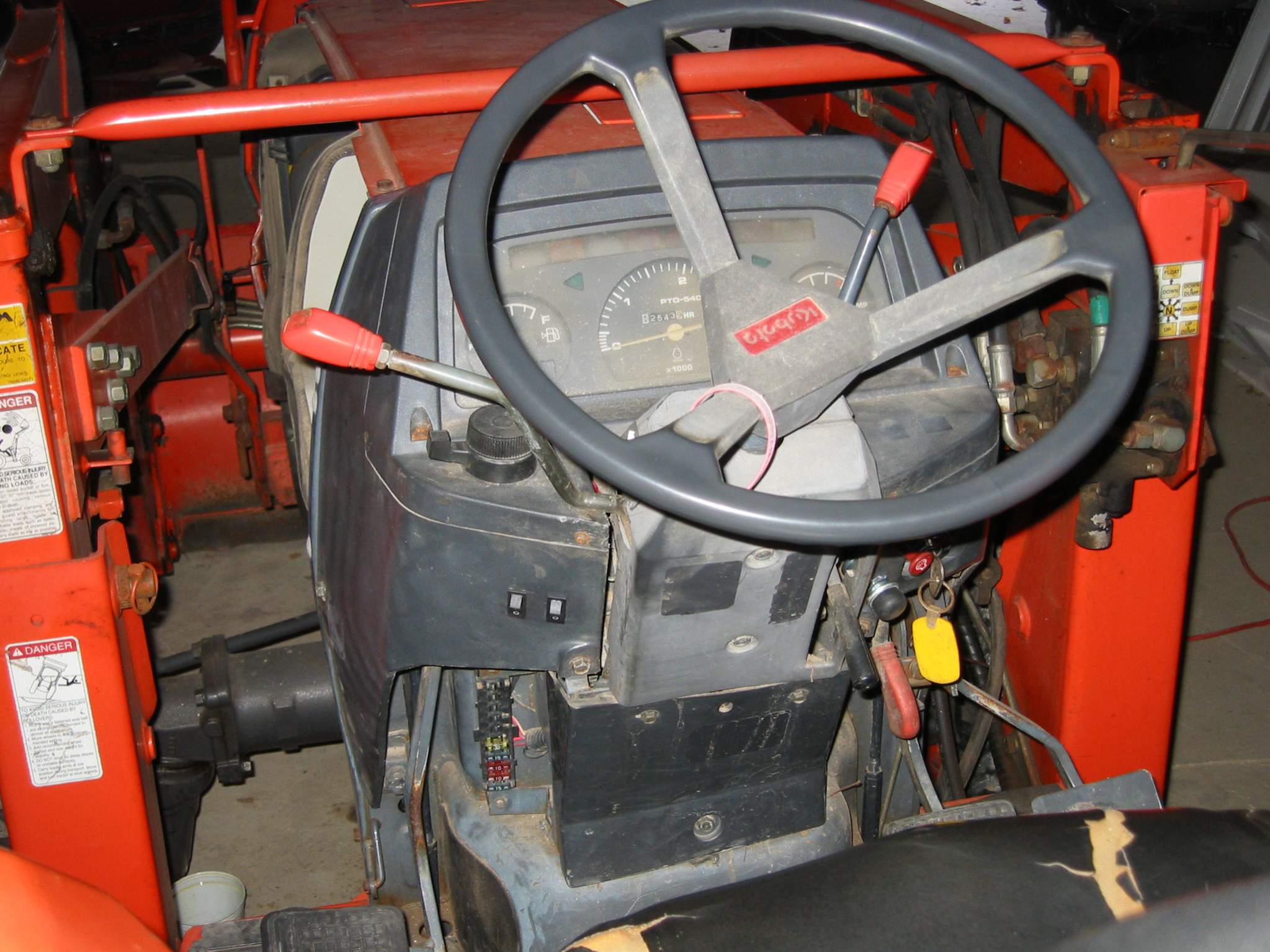

My GP controller stopped working a couple of years ago. My tractor started through the winters anyway - it is an awesome machine with a super-tight engine after 2600 hours :).
I recently put on a cab f'glass canopy with front & rear facing spot lights, so I can run my snowblower at night (rocker switches on the left side of the console). While I was at it, I bypassed the dead controller with a momentary switch (big black button under the key switch in the pic), to assure reliable starting at night (when it is f'n cold). I press the big fat button with the key on, and the glow plug light turns on. I didn't know if the plugs were actually working though, and couldn't figure out any easy way to test them.
SO - a few weeks back, when it was somewhere in the 15-20F range, I gave the key a turn for a second or two - my tractor chugged, but I could tell I was looking at a 10-15 second start time (as it does when it is cold). I then pressed the GP button for 3 seconds and turned the key. "VAROOOOM!!" Instant start - engine couldn't have made more than a quarter-revolution. Looks like they're working to me!! How cool is that!

Mine are 12V, yes. One end of the plugs are tied to the 12V rail, and the controller simply shorts the other end of the plug to ground via a transistor. The indicator light is similarly engaged. I simply sorted both controller outputs together, and tied that node through the switch to ground.
