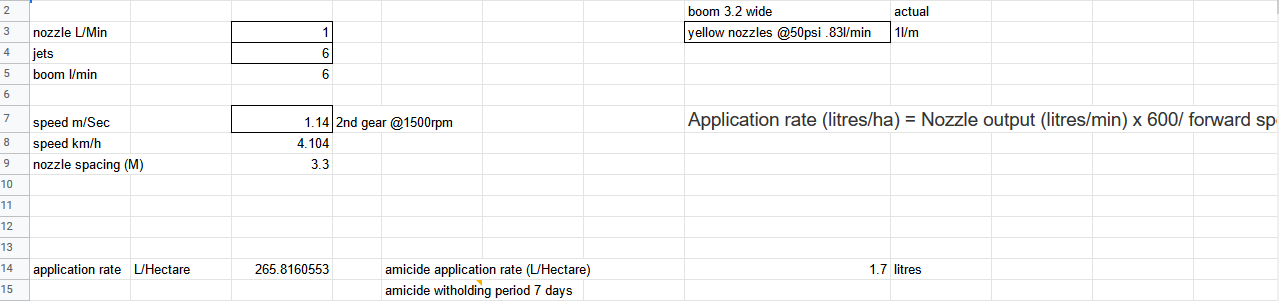

Any experience on the amount to apply? I can work out the carrier volume and tractor speed, but it’s not clear from the label how much product to apply.
you need to consider your nozzle flow rates and the boom width, this will give you the volume per min rate, , you generally match your tips with the volume/speed. make a spreadsheet up, its a lot easier with a spreadsheet, heres my sheed for amicide for example,

thanks, but that isn’t what Im asking. i am asking about amount of product that should be applied, not how to apply it, that is easy to figure out.
