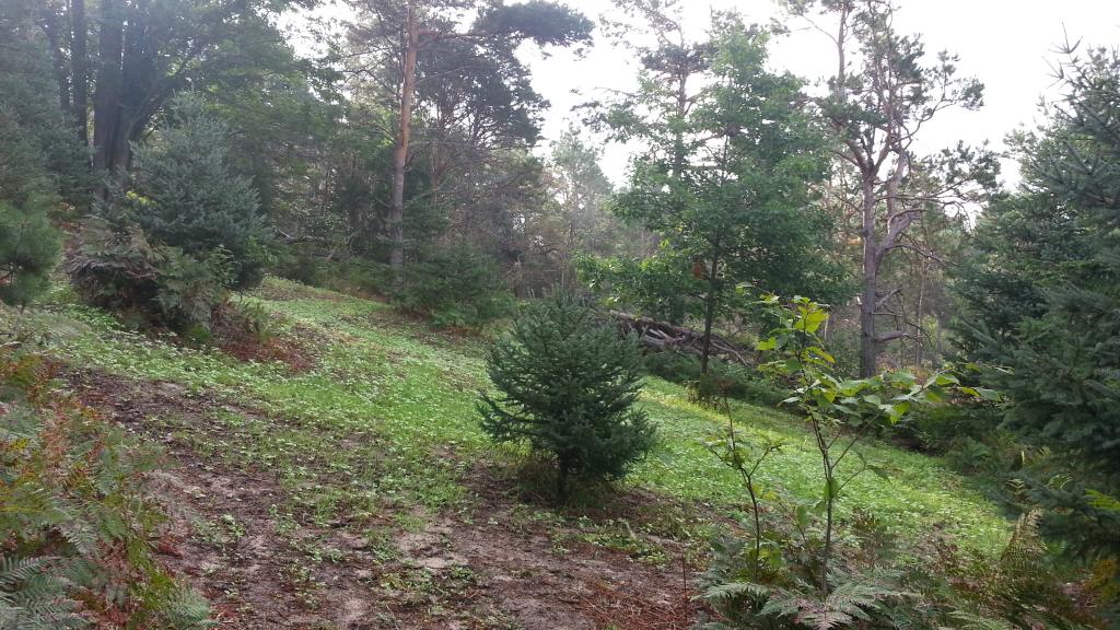

I own 35 acres of hilly property in NW Michigan near Manton MI. Four acres cleared by me, the rest is a Scotch Pine Jungle with a 125' hill splitting the place into two valleys. Not one inch of the place is flat or level.
Eleven different plots sowed in Clover, Purple Top Turnips, Dwarf Essex Rape. Another few in the poor soil areas in Buckwheat. It is mostly sandy but I have been getting good results with appropriate additions of lime/fert and food species. Mix of perennials and annuals to feed all year for Whitetail, Turkey and Ruffed Grouse.
Plenty of pics and info at link including map and layout. Transforming a Scotch Pine jungle. - AR15.COM
Biggest plot is 0.4 acres, smallest is 0.1, tight turning and handling is critical.
Even my quad just clears the 10yd turning circle.
I really know nothing about tractor hillside safety and turning radius while working. You guys are the experts so please advise.
Also some of the trails are cut to ATV sized 50" wide so the compact needs to be near that.

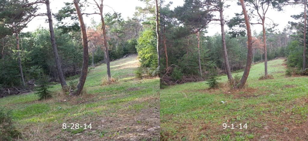

This one of the small hillside plots that concerns me about using a higher centered tractor. My eye says about 15 degrees and maybe more in some areas.
This one too. Starts out mild but really kicks up at the end where it is narrow.

Belly mowers are all finish mowers. 3pt mowers also come in versions that can handle rougher terrain and larger plants: Rotary cutters ("brush hog") and flail mowers.
Realizing that pictures make slopes seem flatter I'd be ok operating my tractor up and down those. They're getting close to where I'd avoid side hilling or do it carefully looking for dips on the low side and rocks on the high side. The only spec for slope operation I found (for a Massey) said 20% all directions. Of course you can operate up and down steeper slopes than you can side hill. You may not want to disc or harrow up and down because erosion but for mowing it doesn't make much difference.
I mow a number of small areas (until I clear more brush). I can get my 70 inch wide and much longer Branson + 5' rotary cutter in the same restricted spaces I operated the 40" wide Kubota B7100 with 42" rotary. It just takes more backing and turning.
Smaller tractors in my limited experience tend to be tippier on slopes than larger ones.

You'll find a tractor will be more maneuverable than an ATV because you'll have split brakes. This will allow you to lock up one wheel and spin around on that wheel. With a 3pt hitch you will be able to lift the attachment off the ground as you do it. Of course that requires the room to do so. If your tractor is 10' long and your attachment on the back is 5' then you will need more than 15'. So a tractor may not make tighter turns than your ATV.
Hills and slops are always an issue. A tractor will have no problem going up and down most hills but turning is always tricky. A tractor has a higher center of gravity and with the front axle mounted on a pivot it'll be more tippy than an ATV. Plus and ATV, being lighter, is much easier to shift your body weight to keep it from rolling.
That being said a tractor will be much easier going in reverse. ATV attachments going in reverse is just like backing up a trailer. A 3pt attachment is simply lifted off the ground. You will want to get a loader for your tractor as it will add weight to the front to offset the weight of the attachment on hills. My experience is that driving up and backing down works best as your rear wheels will have more weight on them, they have the brakes. This leads to one of the reasons why you need a loader as you need front weight when using this method. Instead of making circles you most likely will want to go back and forth.
You will want to adjust your thought process on how you attack your plots but it shouldn't be a problem. The government use to have a simple picture you could print on a 8 1/2"x11" piece of paper. With it you could make a very simple but accurate way of measuring slope grade. If I can find it I'll post a link. It'll help you when trying to determine just how steep your land really is.

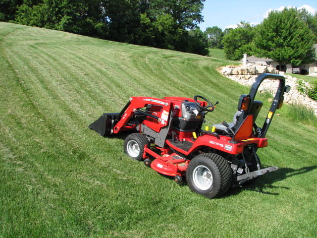

Greetings Postban,
The pictures were helpful. Your slopes in the pictures appear to be considerably more gentle than mine. I sidehill cut some of mine and up and down or angle others. my sidehill cut slopes are either as steep or steeper than your pictures I saw. I tested several sub compacts out of different brands specifically for how they handled slopes as well as other issues.
The machine I liked best for slope activity and tight turning and features and fit and pricing was the Massey GC1715 because I did not need a backhoe or the price of one LOL.
I also purchased a dedicated mulching mower which is unique to Massey. It is a 54 inch deck that measures a total of 55.5 inches wide because there is no chute. Most mulching mowers are fussy on grass height but a dedicated unit like mine has 6 blades on 3 spindles so its capable of taller grass. The important things for me in the deck choice is I wanted narrow width and no exhaust so the cuttings could do fertilizing of the grounds rather than lots of chemicals.
A subcompact will not give you lots of ground clearance like a compact tractor will and that is important to be low to the ground for slopes (very low center of gravity. Mine is 25HP motor so the pto's have a little more power for ground engaging equipment. I have 20 to 30 degree slopes and for 2 years I've cut all the slopes no problem even though as yet I haven't added wheel spacers which will make it even better.
My front end loader has considerable weight lifting capacity which I have tested on very specific load measurements - and I frequently use forks for hauling rock, block, and other items rather than using trailers. My 3PR hitch works great with a 40 gallon sprayer and I can't mention often enough how surprised I am that the sprayer is as beneficial with the wand as it is with the boom (because you can drive along the edges and wand spray as you drive and also spray down into long banks or into tree areas up to 30 feet or more.
I do have turf tires which gives me traction I was told I wouldn't get on snow and ice and in sandy grassed soils. In two years I have not had a single puncture in construction areas or rougher ground. And I have yet to find ice that I would slip on despite living in Wisconsin on heavily sloped street and driveways. I even go out on lawns with 5 or 6 inches of snow without difficulty.
And this summer I will be adding a mini grapple. What is that you ask? Instead of a 4 foot wide grapple - I want something that is much narrower that I can reach into tighter places to pick up logs or rocks (rocks up to 28 inches diameter. A mini grapple is just a couple inches over 1 foot wide yet I can grab and move a log or rock equal to the maximum capacity of the front end loader. And because of its weight only being 77 pounds - it allows more payload carried than larger grapples.
The GC1715 I chose for ground engaging future needs also like tillers or rear blades or post hole diggers or for flipping my forks on to the 3pt for even heavier lifting loads.
Lastly - for rougher terrain or washboard lawns - my tractor choice comes with a seat that is both coil supported and spring supported - offering a better ride from jostling. The Massey tractor AND engine are engineered and built by the same award winning company exclusively for Massey for many years. And like the Kubota BX and some Yanmar tractors - the MAssey engine compartment is forward cooled - not front end cooled - keeping tractor engine area and operator cleaner and better heat regulated.
Picture here shows some of numerous of our slopes. However - the fel and bucket are not part of my lawn cutting process LOL
