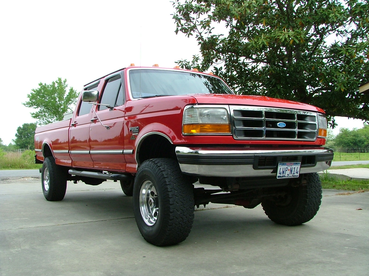

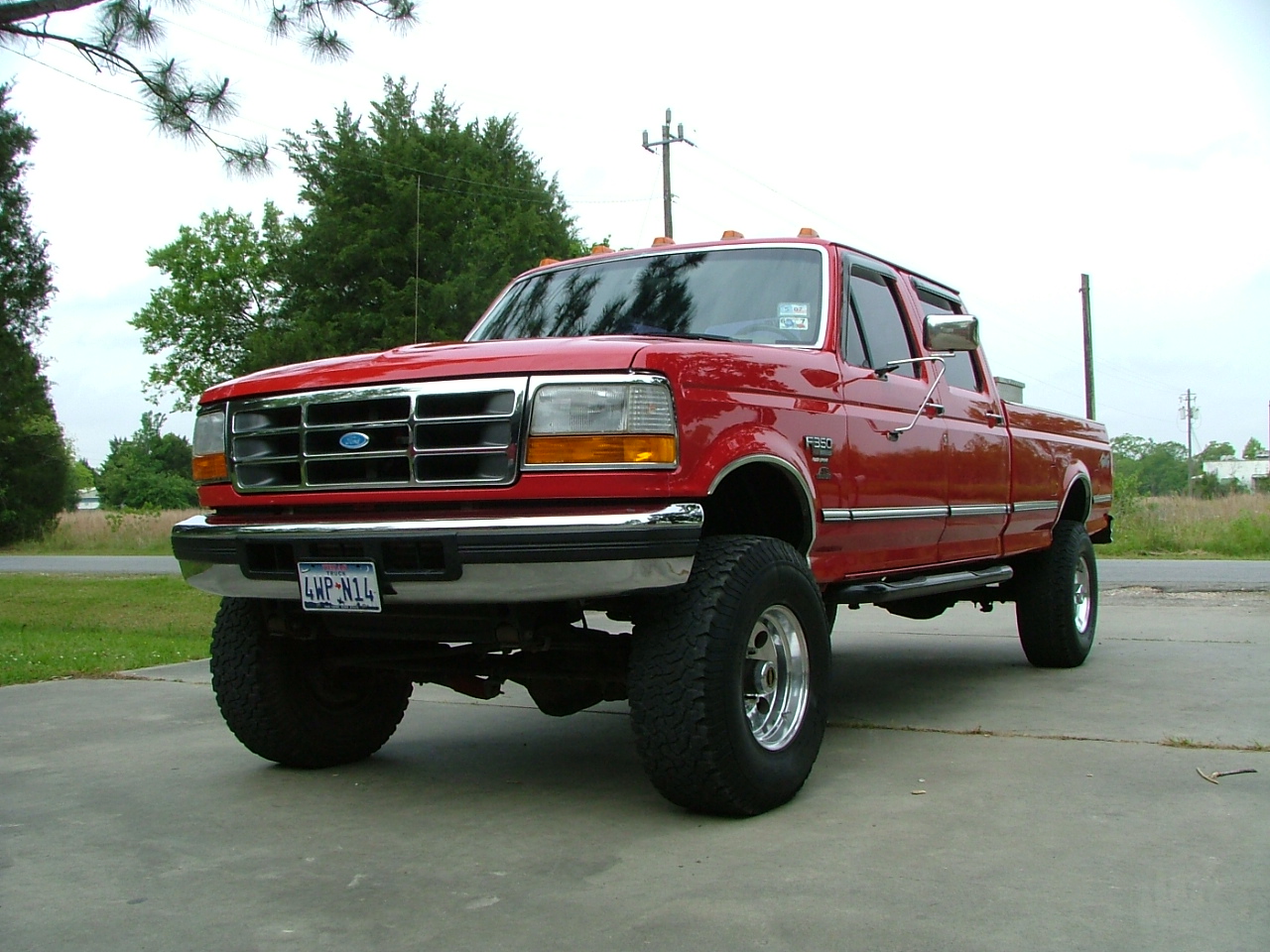

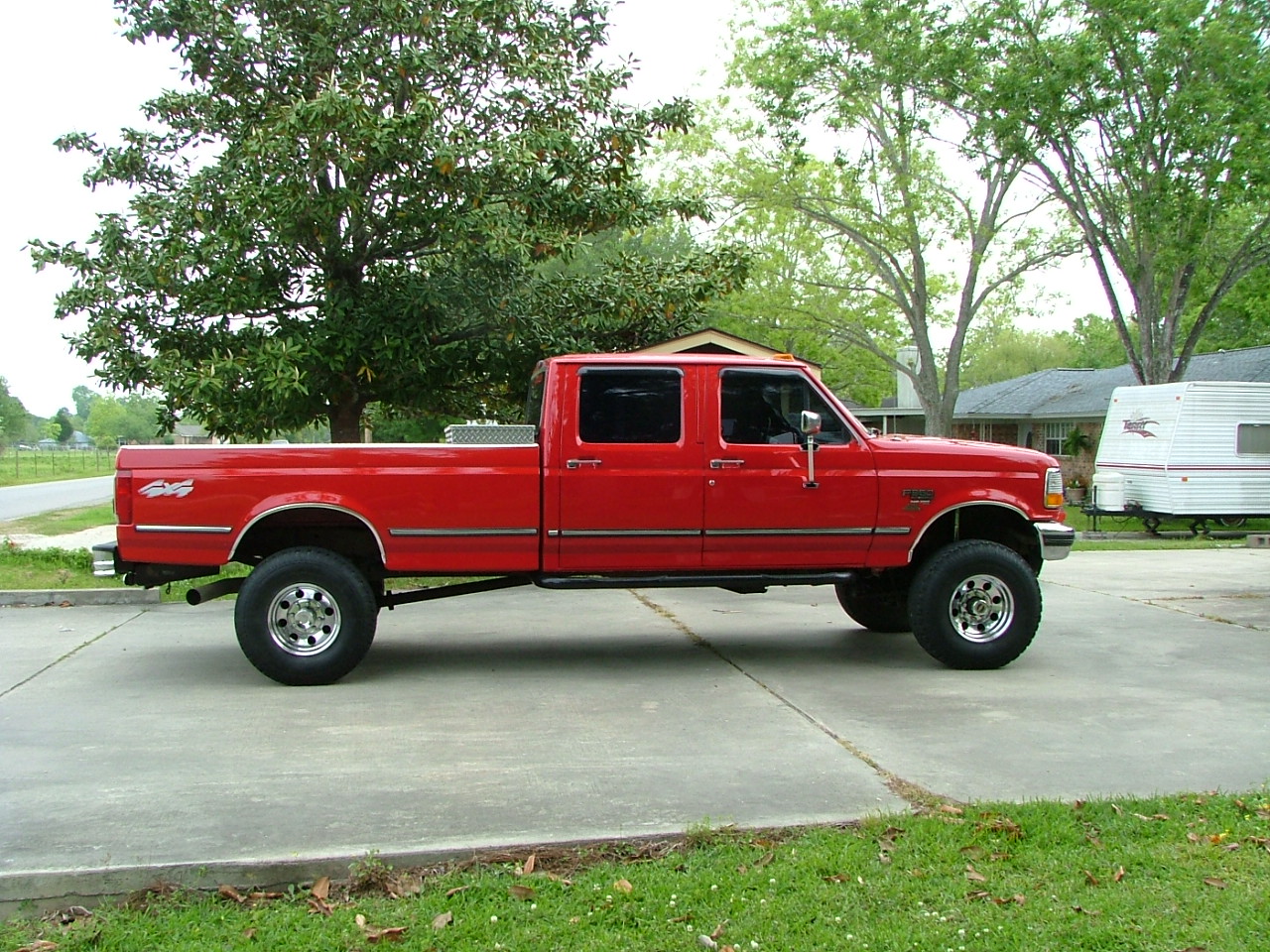

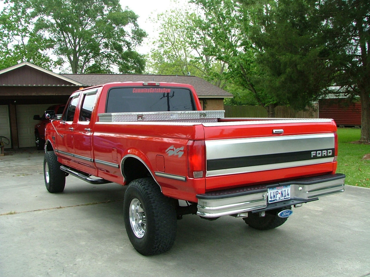

My F-350 Powerstroke came with 3.55s. When I went with 35" tires I lost a considerable amount of low end so I had it regeared to 4.11's it was a nice combination.
IMO that body style was the best looking Ford ever produced..
Still miss mine to this day..
   / Going to look at a 1995 F-250 w/ 7.3 #10
"IMO that body style was the best looking Ford ever produced"
I agree, had a 1994 f250 w/ 351 that I should never have sold.
