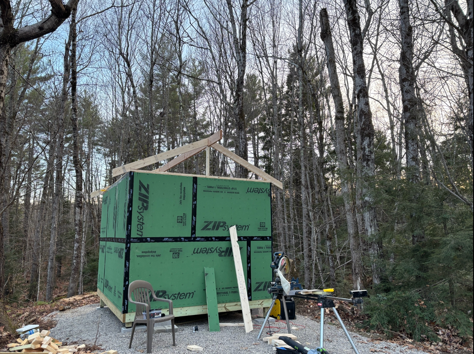

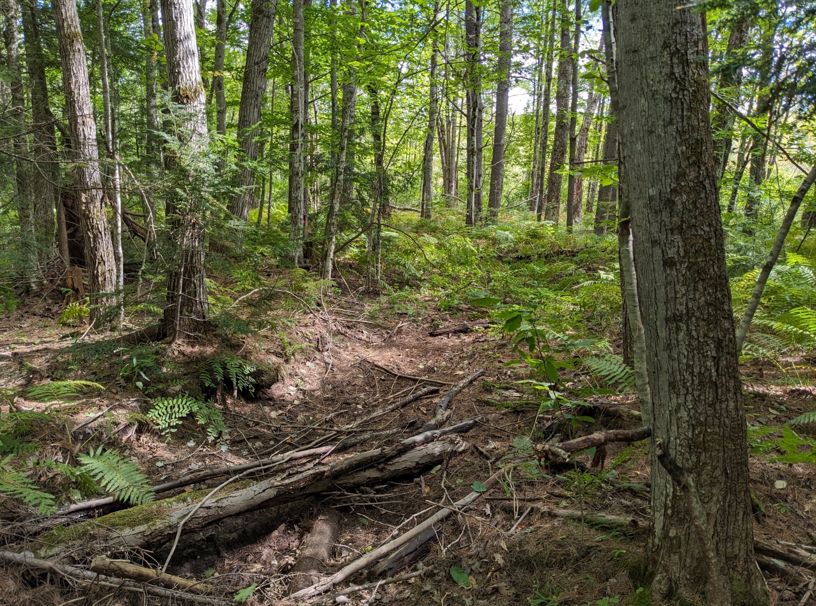

Thanks for that info, I did not realize they would give that much sap in a day. So I think you’re right I may just have to take a day or two off. I don’t have a great pic of the trees but here’s what I found on my tablet where I am building a little mini cabin/ shed that shows some of the trees.

nice trees.... I would put one tap in trees with diameter 12" or bigger. 2 taps when about 18" and 3 taps if bigger than 22" diameter. That's kinda standard in our parts.
Of course there is the science then there is the art so you will get tonnes of opinions and techniques. Old school vs book learning types can argue forever. We always have good arguements about whats right between the old timers in these parts.
Lots of resources on internet and your local gov't extension office probably has recommendations of their own. Check with your local ag. office my experience lots of good people that want to try and help.
Sap normally flows when night time temps below freezing and daytime temps above freezing
