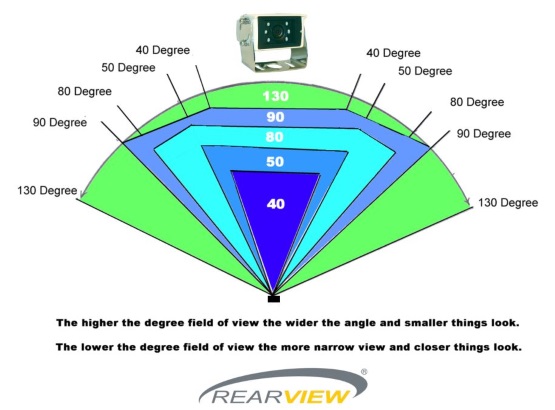

I don't think a backup camera will work well for you, the field of view is too wide.
You need a narrower field of view to see what is happening back there.
More info here: Rearview Systems: Backup Camera Safety Kits & Accessories
