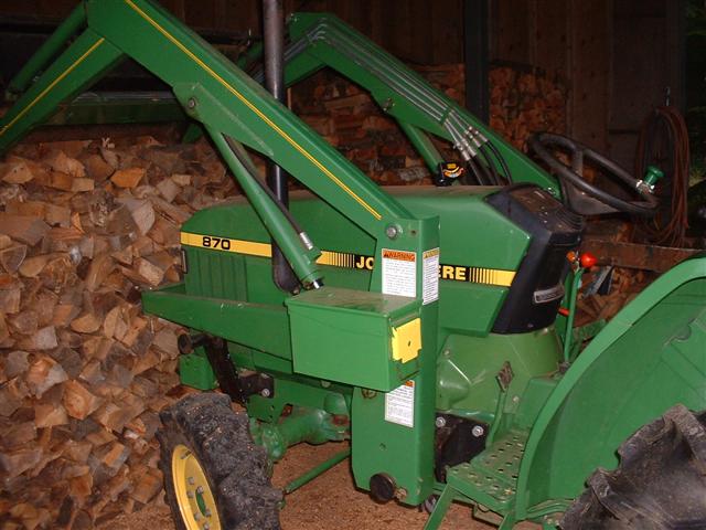

Ammo cans are great if you don't load them too heavy. I mounted mine to the FEL. I holds all the tools, rags, and chain I need.

   / Good location for a tools box on Kubota 7610
Did you weld the ammo can or use bolts?
   / Good location for a tools box on Kubota 7610 #8
</font><font color="blue" class="small">( Did you weld the ammo can or use bolts?)</font>
I bolted mine; the ammo cans are thin enough that it might be difficult to weld them to thicker metal like a FEL.
   / Good location for a tools box on Kubota 7610 #9
I bolted it. Just drilled the FEL support arm and used some 3/8 machine bolts. I also added a piece of high moly plastic between the can and the FEL due to the can's stamped construction. Kept things flushed up without deforming the ammo can. /forums/images/graemlins/cool.gif
