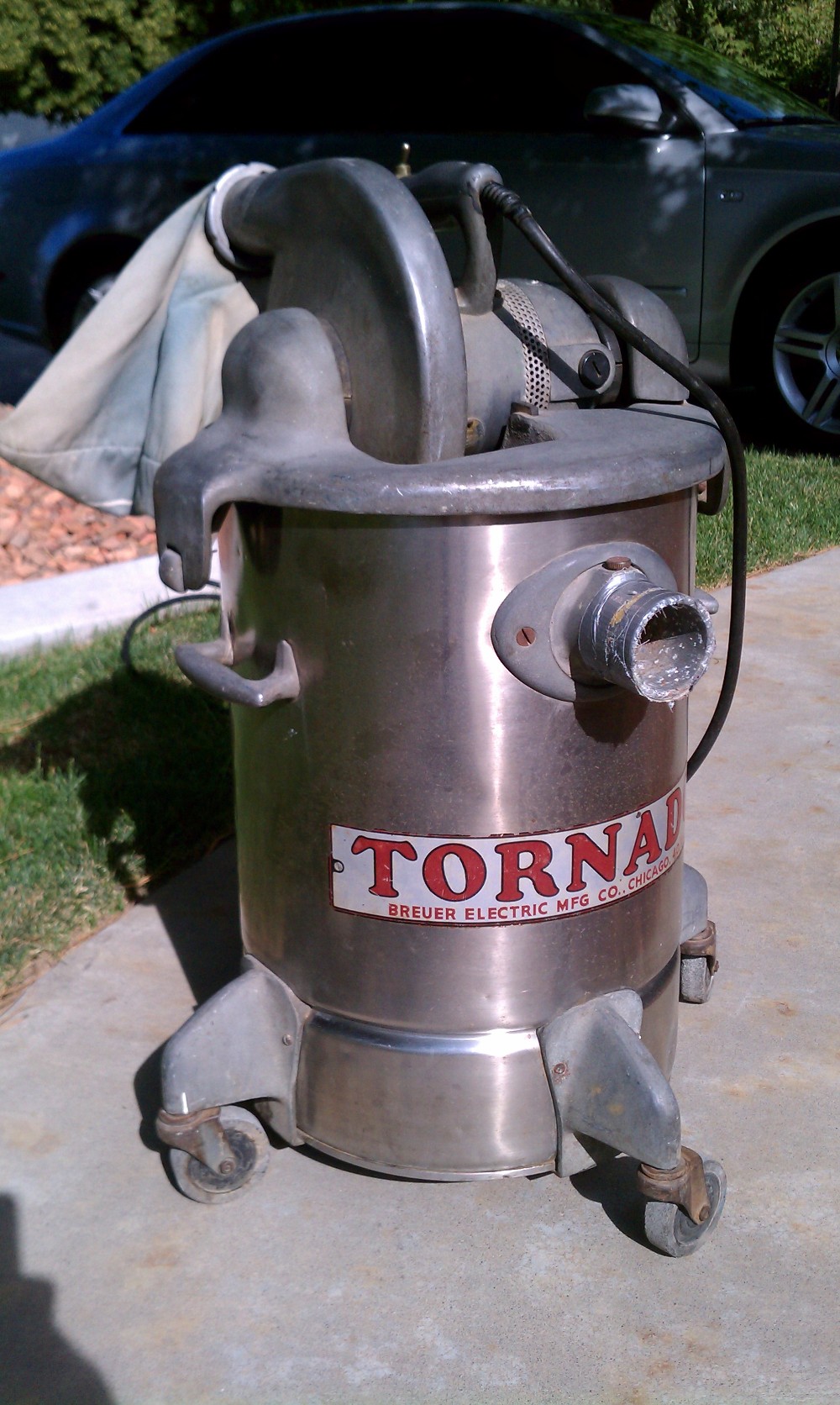

I inherited a great old shop vac from my dad... it is dry only with a huge bag that captures the exhaust in addition to the steel canister base... the bag traps all the dust and fine particals.
It is loud and heavy with a very heavy hose... built like a tank... circa 1960
On occasion, I could use something more portable to take with me for on the job cleanup...
Tried a few from sears and home depot that friends have and they are fine for large stuff... don't work well for cement and drywall dust at all... plug up in no time and they tend to be loud and hoses are cheap.
Any recomendations for a good all around portable shop vac... does not have to wet/dry although wet/dry would be fine too.

Never thought of a water prefilter...
Dad's old 1960 cleaner has no filters... just a large steel tank and an equally large cloth bag... can use it all day and never have to empty either...
Only draw back is too heavy to be portable and not made for wet.

Doesn't the air flow through the cloth bag, making it the filter that protects the motor and fan?
   / Good Portable Shop Vacuum at reasonable cost?
No... it is the exhaust air along with the dust that flows through the bag... incredible suction and dust and a couple of hours of sawdust doesn't evan phase it...
No filters inside... when turned on, the bag inflates.
Very common when I was a child at the detail shops for cars... way back when.
