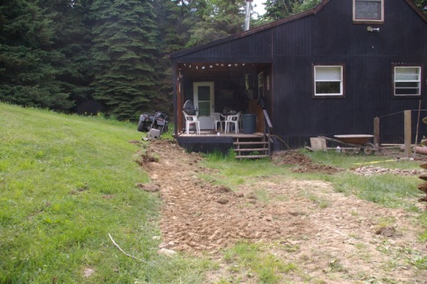

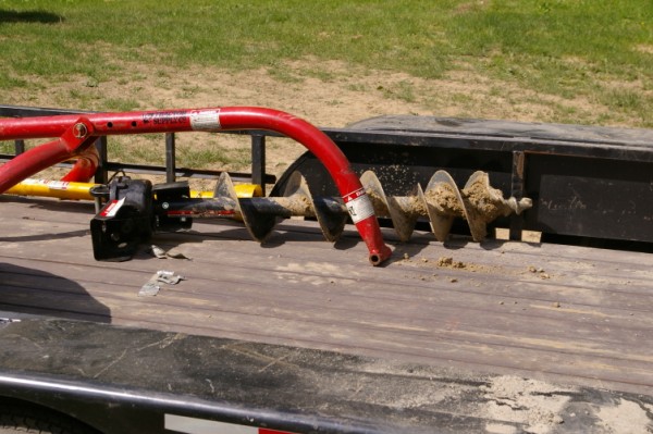

I think it all depends on the cost difference and how much you will be using it. I have a TSC brand for three years and use it quite a bit. I dug over 120 9" holes with it and this past weekend I dug 12 more in very Rocky soil. Only problems I had was breaking shear pins but that is what they are for.
