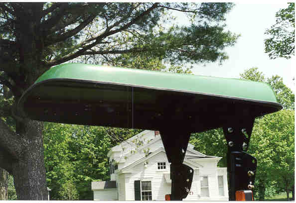

Look at the Firebird Bucktop canopy for your JD 4310. See attachment for a view of mine on my JD 4710. They are lightweight (about 30lbs) and are secured to the ROPS with 4 U-bolts. You can buy them simple and plain or souped up with radio/stereo systems. /forums/images/graemlins/laugh.gif
Firebird Bucktop Canopy
...Bob

Looks good! I like the design, but am converned about the fiberglass, should I? The Femco is ABS.

<font color="blue">"...but am concerned about the fiberglass, should I?"</font>

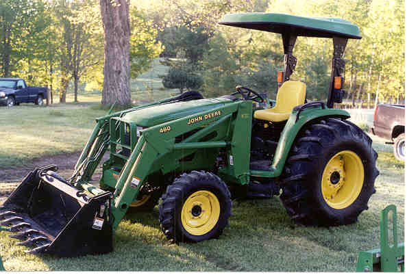

This is a tough piece of fiberglass Mike. I'm real happy with it. The only damage I can see occurring is if I run the thing into a low hanging branch or something similar. Here's another attachment showing the Bucktop from a distance.
...Bob

Thanks Soundguy! I think they look GREAT on a NH like yours, just not sure on the 4x10 Deere. But it sure is bomb proof. I am definately keeping it in mind.
BTW - great looking Jubilee, you must be a proud "dad":
