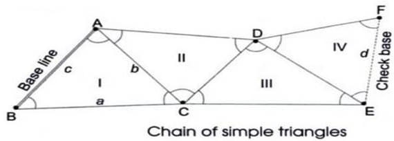

Our contractor will be digging a gravity drain approximately 11 ft below grade from the foundation of our new house to outfall approximately 400 ft away. Due to the layout of our house and contours around it, the drain pipe will need to change directions a few times. It will be very difficult to know the path of the underground pipe a few years from now.
I am looking for a way to record the location of the drain pipe just in case we need to access it later. I have a handheld GPS receiver which I can use to record the path of the pipe very quickly and easily but it is only good down to 10 ft or so which is not good enough. So apart from burying some metal objects near ground surface along the path which I can pick up later with a metal detector, is there any other way I can record the path fairly accurately and easily ?

Lay a thin copper wire in trench with pipe. That is common practice with utility

I would just drive some rebar along the path, and maybe record the distance between them.

- I'd take measurements from two corners of your house to the first bend and record them.
- Then make an arbitrary point about 10'-20' to the side of the first bend and take two more measurements from the house corners to the arbitrary point and record those.
- Then take measurements from the first bend and the arbitrary point to the 2nd bend.
- Record and repeat with a 2nd arbitrary point, etc... until you get all of the bends mapped.
Easy peasy.
Then draw out a little diagram with all your points and measurements and put it in your big binder of house data (everyone should have one).
Make a copy of everything in your big binder of house data (everyone should have one) and keep it in a safe deposit box at your bank, credit union, etc...

Like this...
Your house wall is the baseline.
C is the first bend.
D is your first arbitrary point.
E is your 2nd bend.
F is your next arbitrary point.

You can't go wrong with this if you record accurate measurements and keep you tape measure straight.
If you cant get to each bend, just make more arbitrary points. Piece of cake. No electronics required. No need to worry if in 15 years the technology you used to record it is compatible with the current tech, etc...

Like this...
E is your 2nd bend.
This is the way to do it. I used a modified version of this since I have multiple buildings and I can reference off of them. I also include the depth if I can get it. (keeping in mind that the depth will change based on erosion, grading, etc.)
