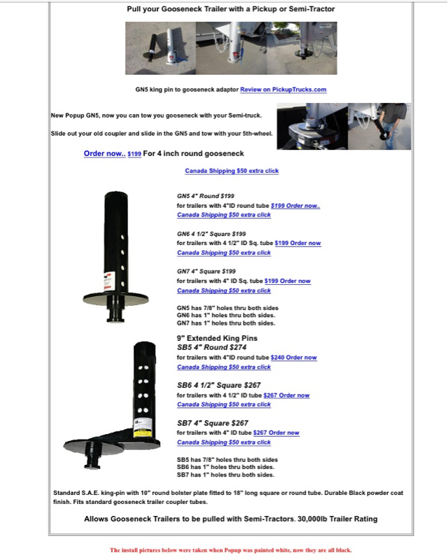

For me I would choose the goose neck over the bumper pull any day. I know a few people that have king pin adapters on there goose necks and really like them. They pull campers too and don't have to remove and replace the hitches all the time and a bit easier for them to see the hitch when hooking up. You can purchase a standard gooseneck trailer then replace the ball hitch with something like this.
