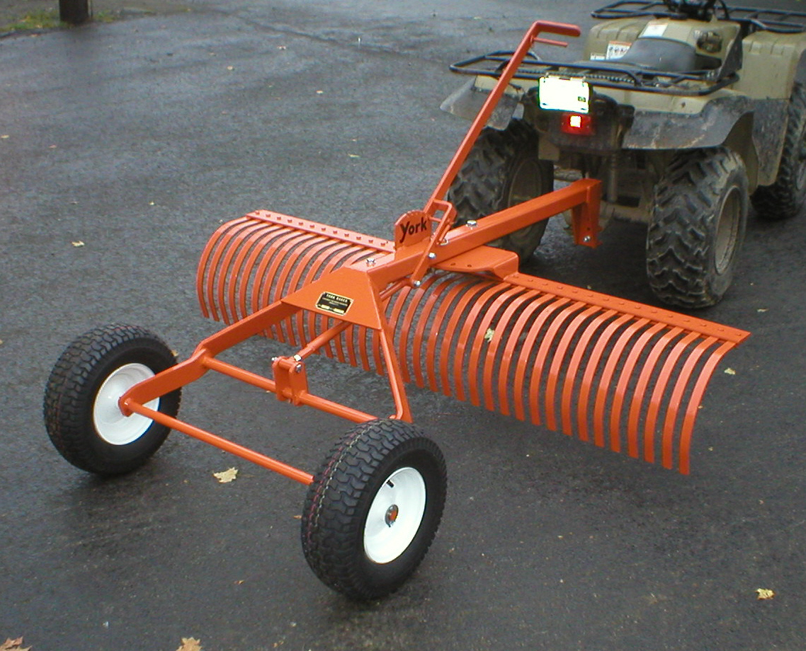

YORK makes a rake with a fold down blade that rides on sulky wheels.
TA6B
I have one, and works a treat on anything that sticks up. I find the height adjuster on the tool is good for most needs, but when the attach point is fitted to the three point tool bar, every degree of subtlety is obtained. I had mine fitted with a hydraulic cylinder, but removed that when I went from "garden tractor" to a fully functional 3pth.

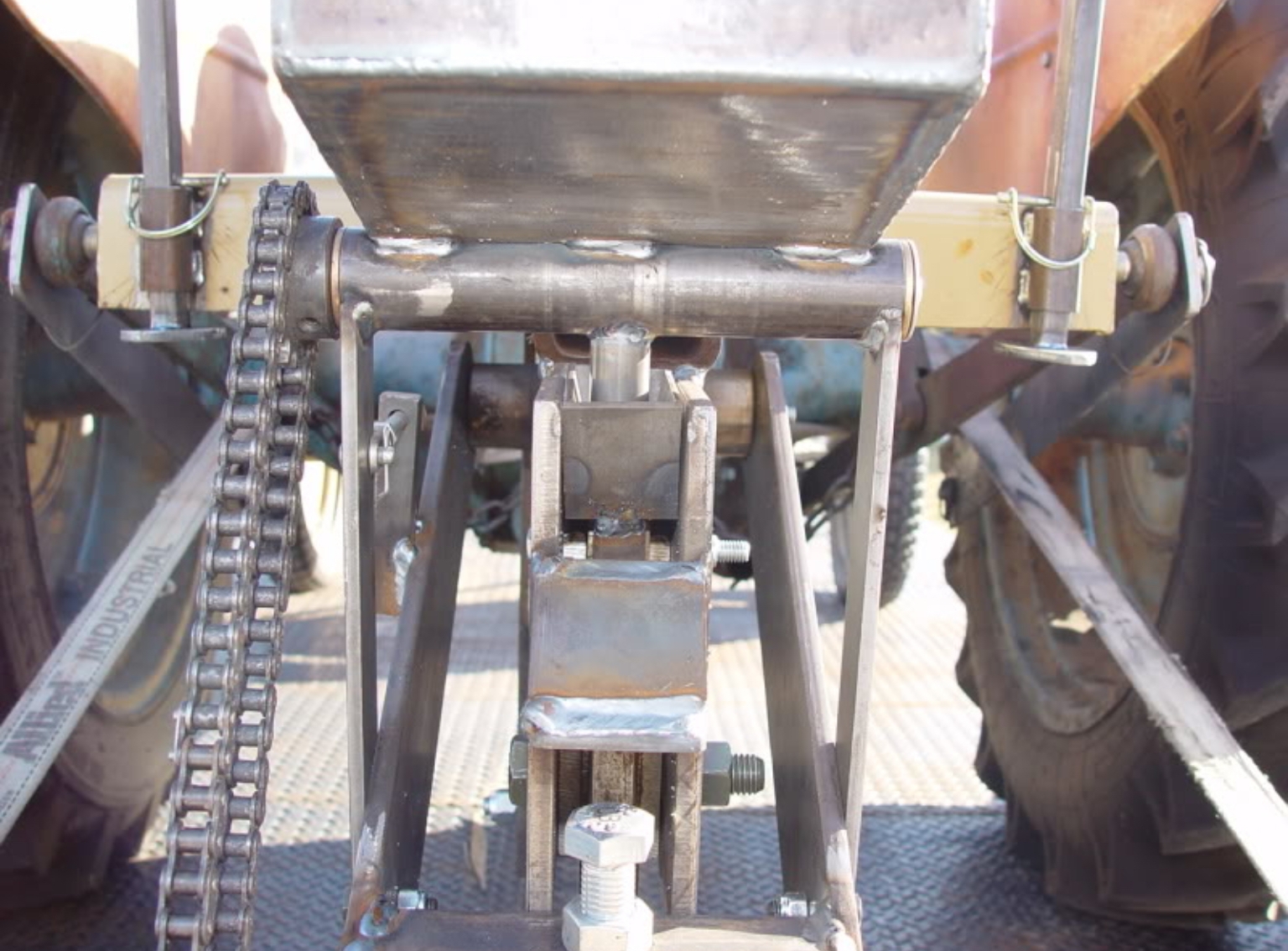

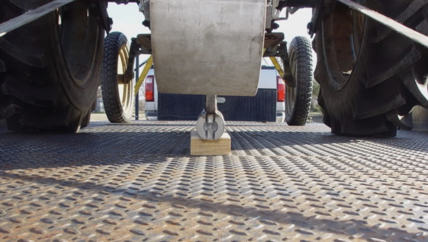

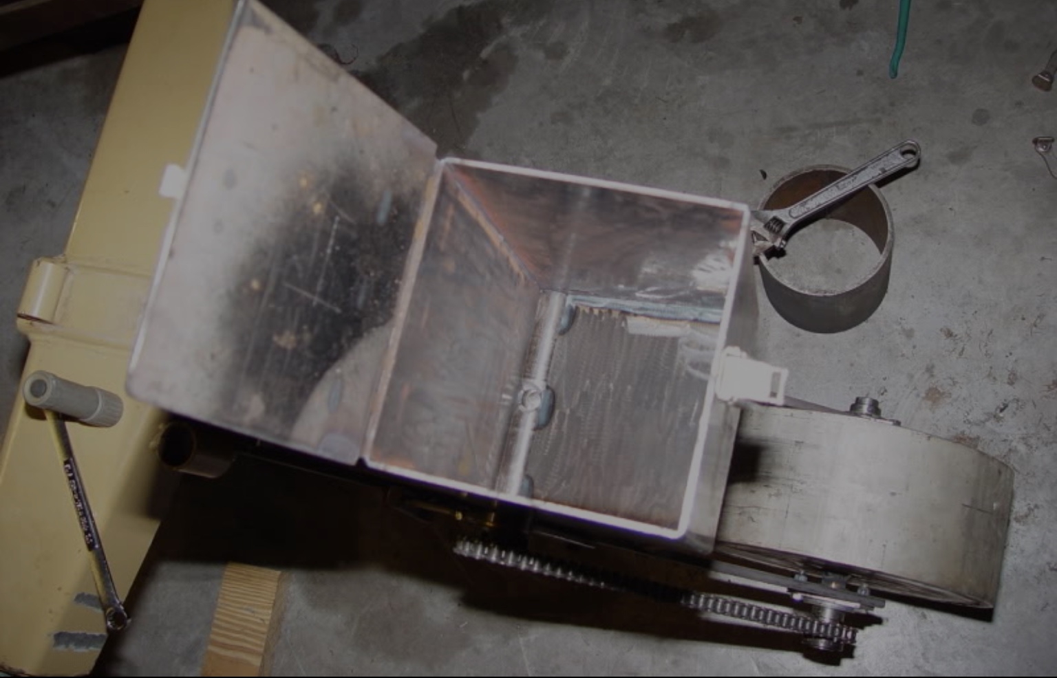

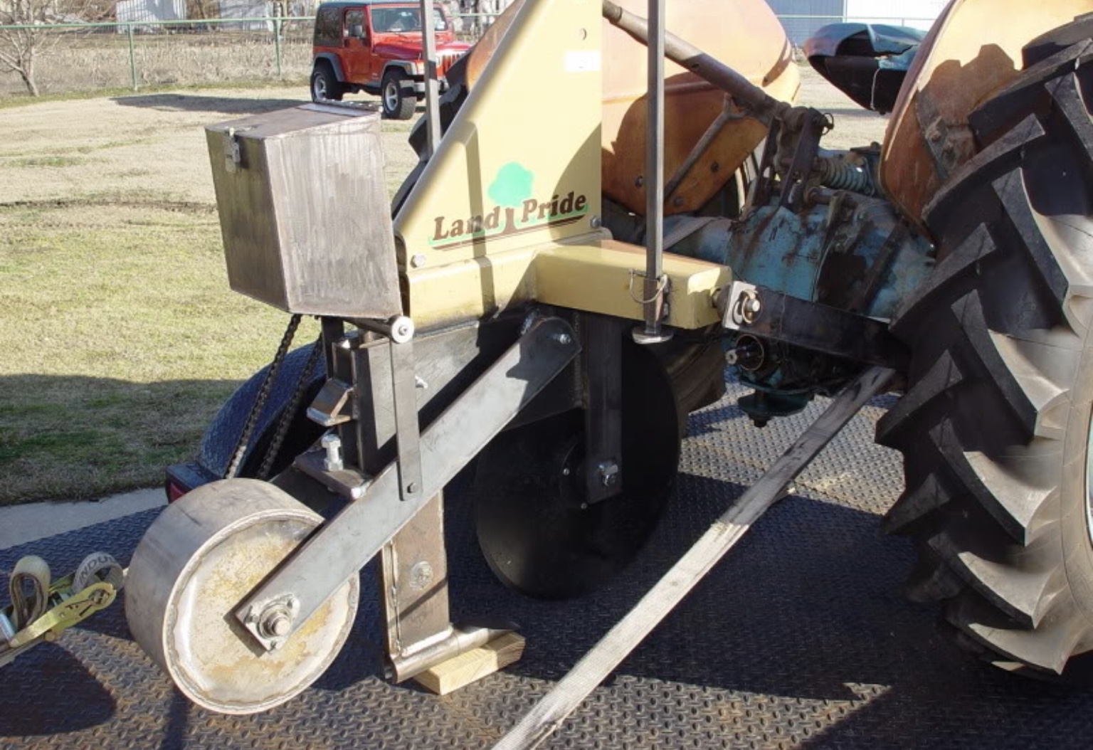

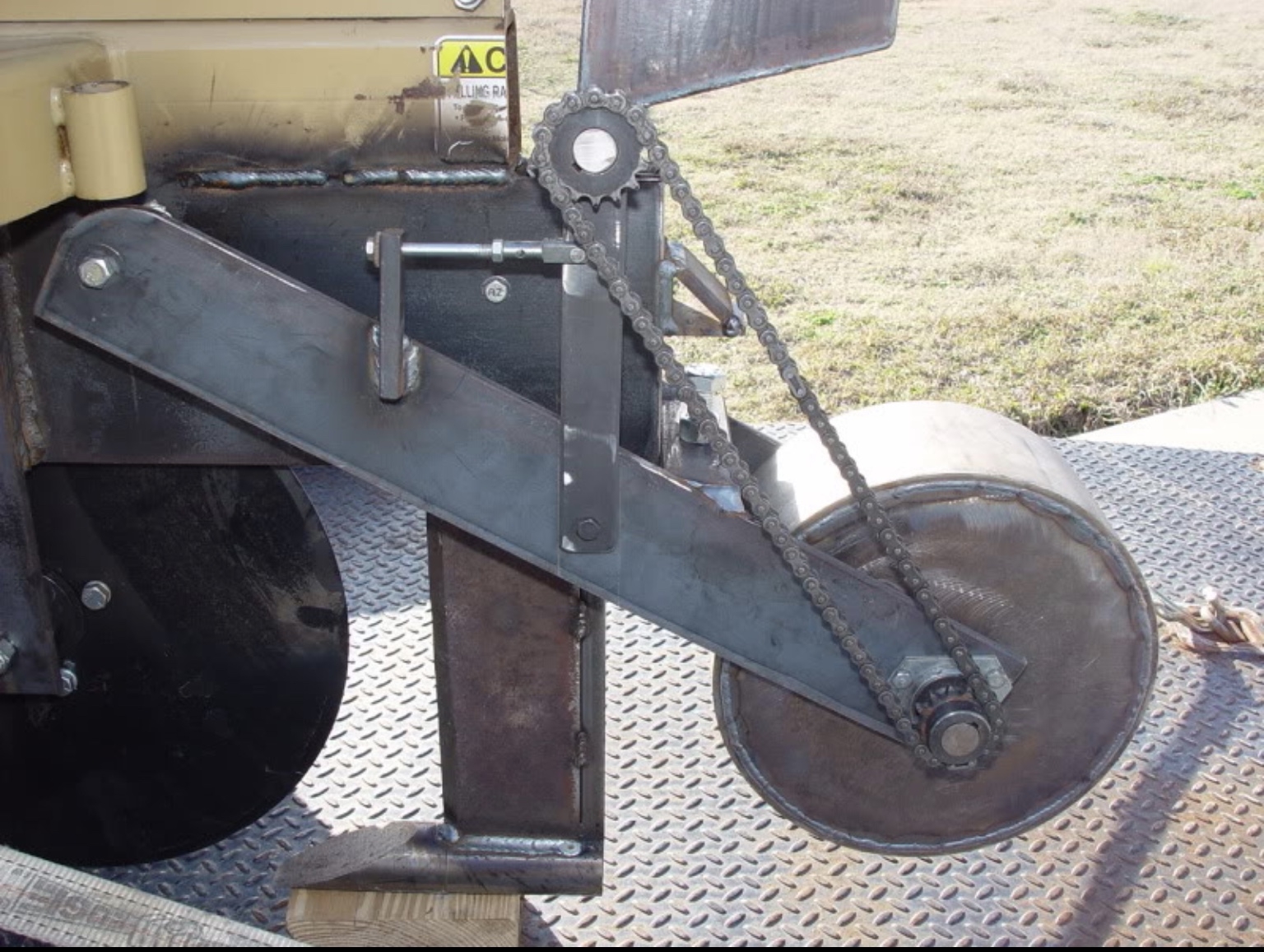

I built this implement that creates a tunnel under ground for them and drops a thimble full of poisoned seeds every ~3ft. No more piles of dirt.

If you want To stop the dirt piles you need to kill the animals that are piling them up. They also bring rocks to the surface here so mowers can throw them and bust out windows.
View attachment 818932View attachment 818933View attachment 818934View attachment 818935View attachment 818936

There used to be an implement sold that does exactly as you say. It was called the Eaton burrow builder. A great way to treat a heavy gopher infestation.
