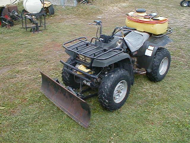

I traded some unwanted stuff for a '96 Yamaha Big Bear 350. I've included a picture below.
The 4-wheeler is in rough shape. Among other things, it has a bent wheel, needs a new pull chord, the petcock leaks, and there's a squeak coming from the front axle somewhere. It runs great, though; and considering what I gave for it, I'm more than happy with the exchange.

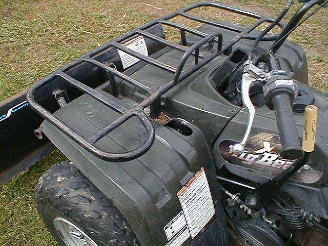

2) What's the hole in the cowling to the left of the handlebars in the second picture? It looks like something goes there, but I've searched images on google and can't figure out what it would be.

As far as the hole, I bet that was for a snorkel so you can go in deep water without getting any in the intake.
Here is a picture of a newer Big Bear that looks to have a snorkel in the same place.

The hole in the fender is for the high /low shifter. This feature was discontinued in 1996, but big bears continued to have this cut out through 1998. The squeak is probably a bad front u joint on the front drive shaft, i changed a few on my 1998, they are very expensive from yamaha, but aftermarket ones are available through tucker rocky and parts unlimited. Don't waste your time trying to cross them over at your local napa or driveline shop, as I wasted countless hours doing this and concluded that they are oddbals only used by yamaha on some grizzlies, Timberwolves and big bears. I bought most of my oem parts from babbits sports center in michigan, they have all of the diagrams with part numbers and prices online accessable from they're site.
