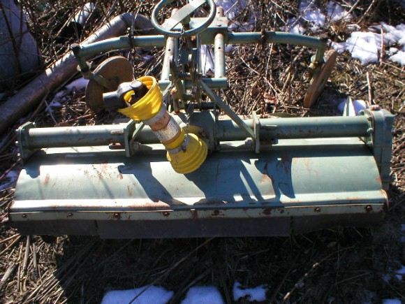

Sure looks like a Yanmar tiller to me.
See attached pic of mine
   / Got a tiller
You're right. That is exactly what it looks like. Do you know if there are manuals avaliable? Do the same guys that sell YM tractor parts carry the tiller parts as well?
